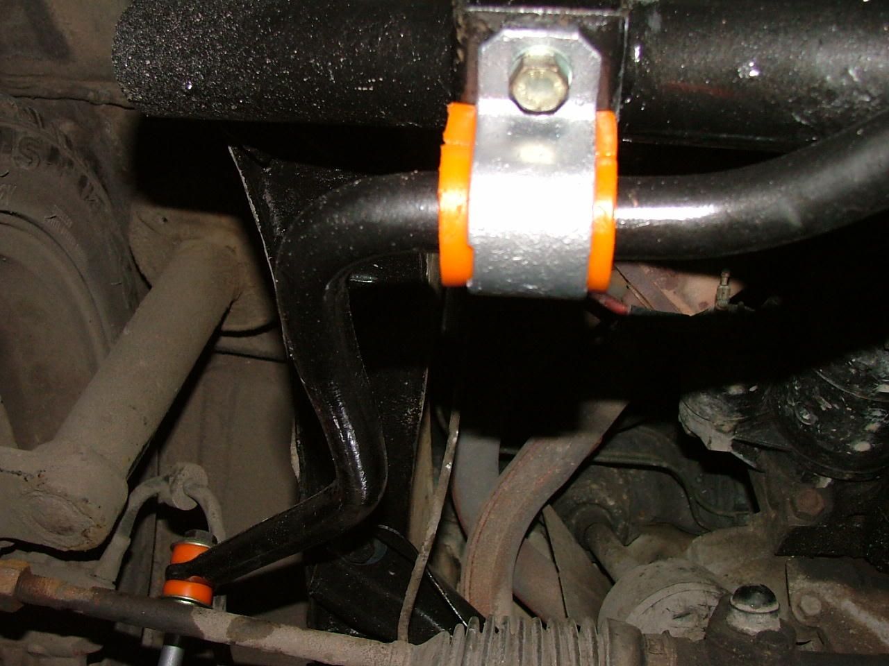

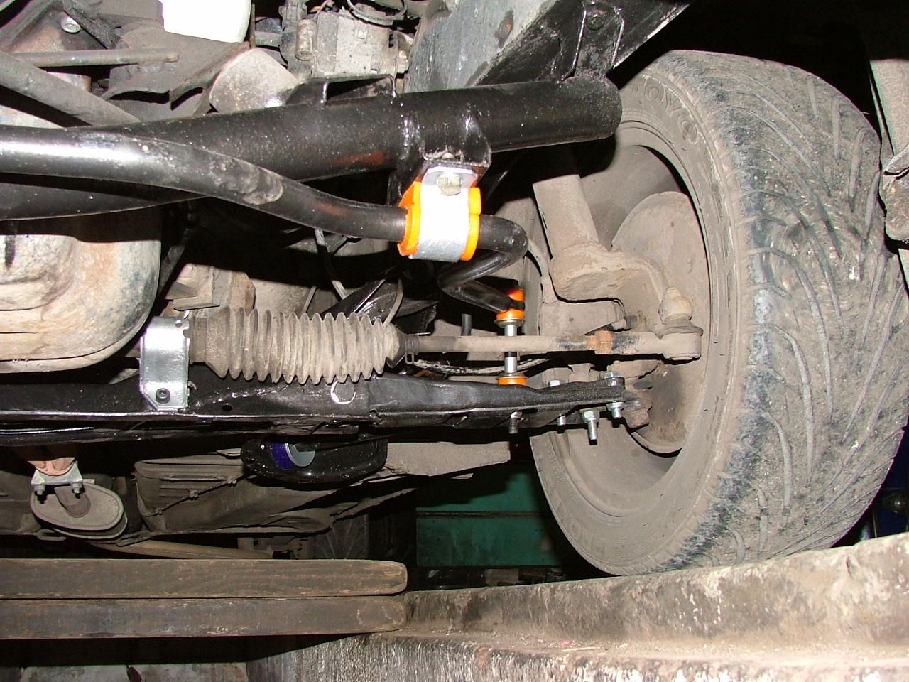

Right been busy this weekend getting the front end together and fitting all the poly bushes. All parts have been replaced or reconned, all bolts are new. Job isnt too bad but goes a hell of a lot slower when you break one of the main bolts off flush with the chassis legs!!!! :roll: So it had to be drilled and rethreaded.
Am pleased with the result though. Well worth upgrading to the poly bushes guys!! As soon as i drove out of the garage i could tell a change, the back is a bit more happy now though as the front is much much tighter.
The strengthening seems to work too abnd i am more than happy with the results!!! Just the shocks and springs themselves to do now!!!
Ever since the ice incident the pass wishbone has been bent and from the pics you can see the full extent of the damage and i must admit the paly in the bushes is mad and quite scary actually side to side movement was 2-3"s!!!!
Anyways pics
Cheers Adam
Oval hole????? :roll:
Dents????
You can see the uneven tension on the bushes here!!!
Bent wishbone!!
Comparing arch spacing
Old
New

Post by petefarrell360 » 30 Jan 2006 01:10 am
Top job that man and Dai has certainly done an excellent job developing these parts. I really should look at doing the 360 one day, but it felt sooo much better than my old 360 to drive due to the lower mileage that I haven't worried yet.

Post by SteveP » 30 Jan 2006 11:05 am
Nice work Adam, looks very impressive! Must get a ride in your car sometime! A couple of us thought it was going like stink at the meet.

Post by foggyjames » 30 Jan 2006 08:11 pm
Adam kindly helped me pull another 531 yesterday, and we took the mean machine to the scrap yard. It's amazingly tight now considering the springs and shocks are both stock and old!
I definitely have some work to do there...
Posts: 5465
Post by classicswede » 30 Jan 2006 08:50 pm
The crossmember looks good in the flesh after a good coat of paint. :D
