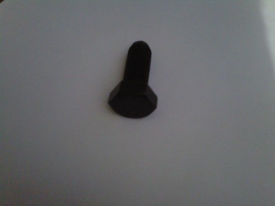

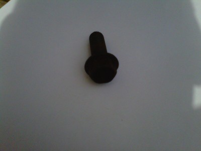

They are quite specific ("100" reference" on it + a kind of Tensilock head). I got from a supplier something different, he said it was nearly the same and perfect for the brakes. I would like to have your advice. What I got is:
Make: SQUF
Reference: D961 M12X1,25X30 10.9 TPBT S 5
They are a bit shorter (2mm), it's 10.9 (strong enough?) and they don't have any Tensilock.
What do you think? Can I use the new bolts? Here crappy Blackberry pictures
The old ones:
The new ones:

Quick question: I made a full restoration of the spare front struts I had (new coating, springs...), they look very fine now... I also replace the whole brake system etc etc... I got new bolts from Volvo for fitting the new brake discs, the last available bolts in Belgium... But of course the bolts for the calipers on the struts are NLA. I really want to change them (rusty and not really looking good)
Make: SQUF
The old ones:
The new ones:

Ah yes - the caliper carrier bolts (the ones through the strut eyes and into the carrier body - not the calliper to the carrier)
Long and hard have I searched for these- no luck so far - at least not with all the OE features (32mm length, serrated flange head, min.10.9grade).
Firstly the markings '100' - this is equivalent to 10.9' next the serrated flange head - this combines locking and load spread.
If you can source bolts long enough then provided you use a "thick" washer (2mm) and appropriate thread locking (there are loctite products quite suitable) then a "normal" (hex) head bolt will indeed be fine.
As you have found Aymat, the easy one to find is 30mm - already 2mm short BEFORE you add a 2mm washer - now you're 4mm short - no!, I would not use them! Go for next preferred length up - ie. 35mm. ( you may need to run an M fine tap through the carriers to clean out the last bit of thread in the carrier bores - they are not always fully threaded through.)

Mac, you surprise me everyday This is exactly what you describe... OE bolts are 32mm long and they have a serrated flange head. I didn't know that 10.9 the same was as 100, very interesting to know.
Well yes, impossible to find a bolt with the same specs, I asked to a lot of industrial suppliers, no chance to find it.
I'll follow your advice, I won't use the 30mm long bolts I got today, I'll buy the 35mm and I'll use a 2mm washer. Do you recommand a specific washer type? All details are welcome so I can directly buy the right one!

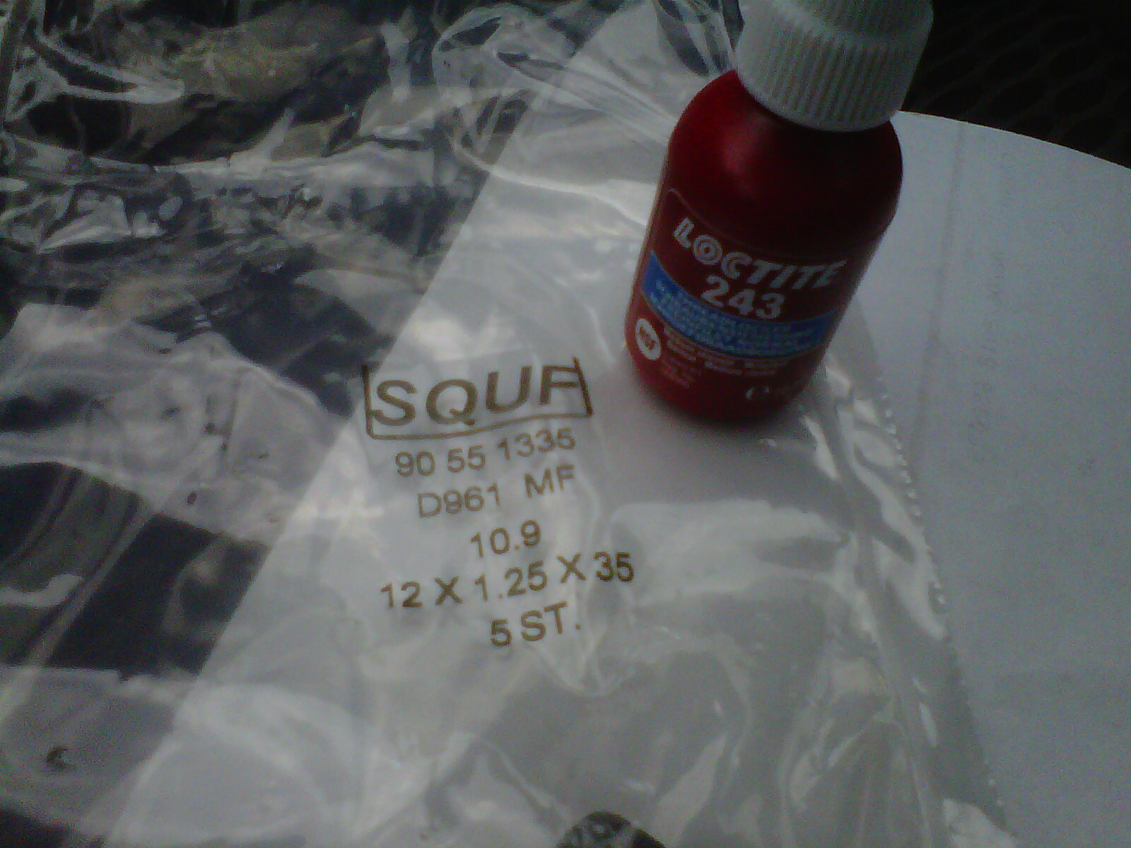

I followed your advice, I bought the same bolts but 35mm long, I have washers too and Loctite.
