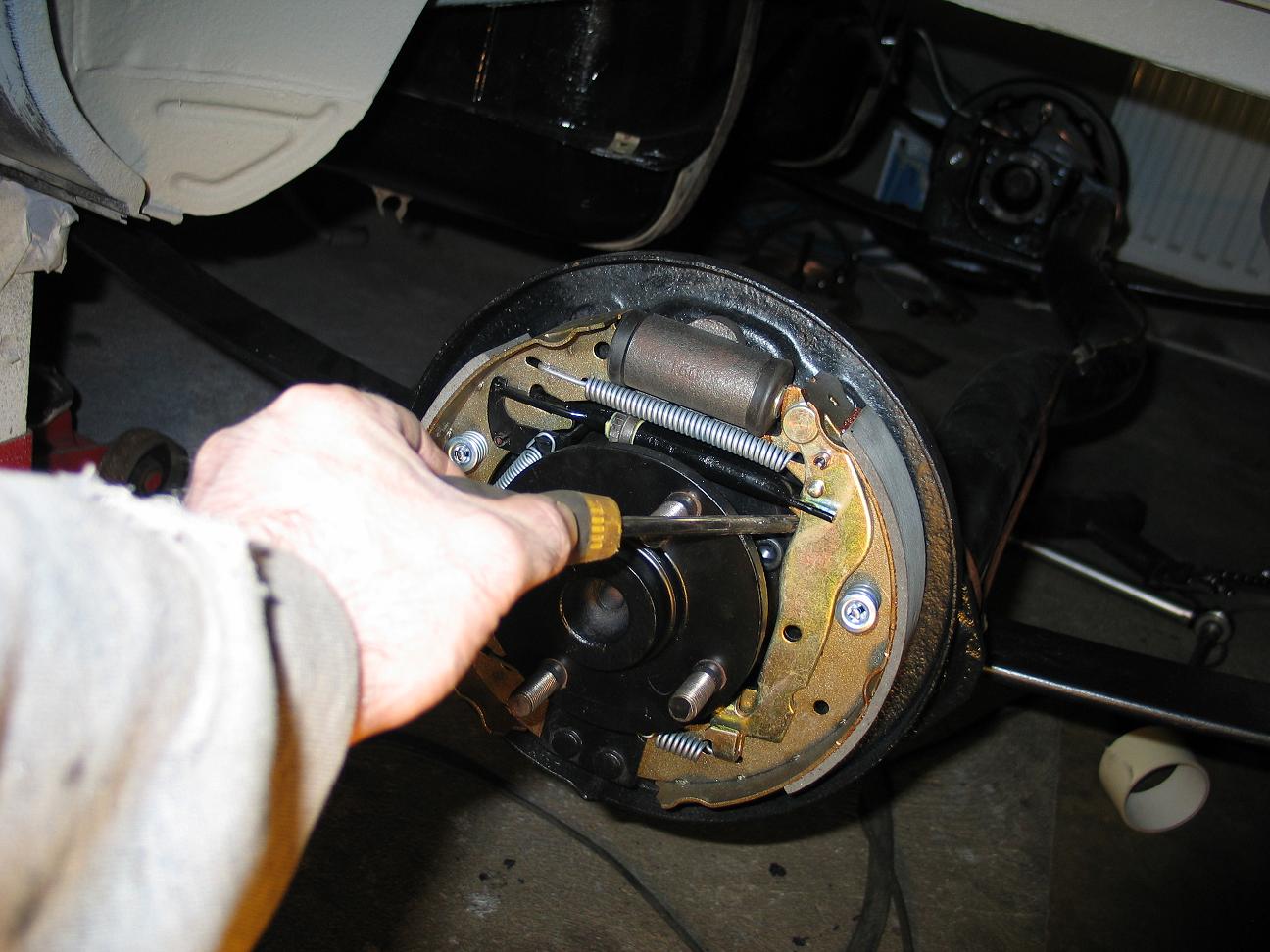

This is how to test the adjuster by levering the screw driver handle to the right against the hub and adjusting arm. You should see the ratchet rotating clearly.
Drum adjuster testing

Post by 360beast » 16 Jul 2016 03:13 pm
Just did the adjuster test and it works perfectly.
I will upload photos of the brakes now if photobucket stops being a PITA.

Nothing major I can see on the photos, looks right.
Thoughts;
-right shoe seems to be sitting a bit low, should be free to move anyway
-adjuster is not all the way home (after testing?)
-make sure its the right side adjuster, they are sided with opposite threads or ratch directions (testing should have eliminated this).
-Watch the little spud on the flat black plate (vertical spring attached to this) that engages with the adjuster fork and drives the ratchet, I had a problem with this because the fork was a little worn and it got stuck in the wrong place. The spud should stop it falling into the fork, but sometimes it doesn't. can't remember any more details, but it might have prevented the shoes pulling fully in, or it might not have adjusted properly.
