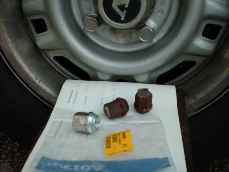

I have had an adventure with the wheelnuts on my 84 360
As I had a puncture I proceeded to remove the wheel nuts using YES my Halfords wheel brace But discovered the rust had enlarged the size of the nut to about 20mm so I had to call out the RAC to use a powered spanner to remove it
Don't want to get anyone worried the rust only occurs on the older type wheel nuts with a chrome cap over the top for a good finish as in MK1 cars with no hub cap fitted I never had this problem with my other 300 series cars with a good 19mm biter of a wheel nut

From what I know they are all 19mm (Mickt the porblem with the nuts swelling to 20mm is common on all the alloy coated nut as fitted to 300's and 200's). The aearly production (Mk2/Mk3) steel wheel cars had a very std short nut that was then changed to a long nut.
I do have new nuts available that are dome nuts to keep moisture out.
