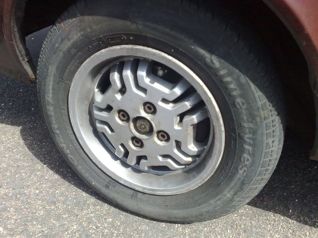

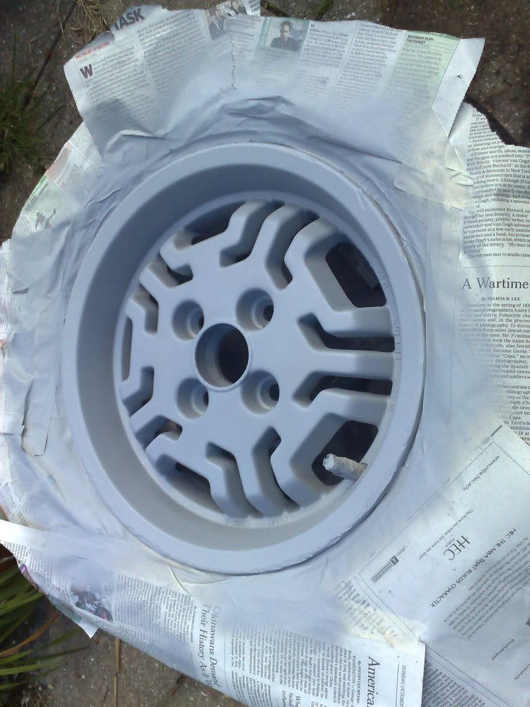

Before i could start spraying the wheels i needed to prep them, to do this i used 600 grade wet/dry paper and basically rubbed down the wheel to get rid of the original laquer and most of the paint a muck which covered the wheel, once this was done i went over the wheel with white spirit to remove and grease which could be left on the wheel. once this was done i masked the tire and sprayed the wheel with grey primer which took about 3 coats to get a nice even finish.
Heres a pic of the wheel before i started and after i prept and primed(1st Coat) the wheel.

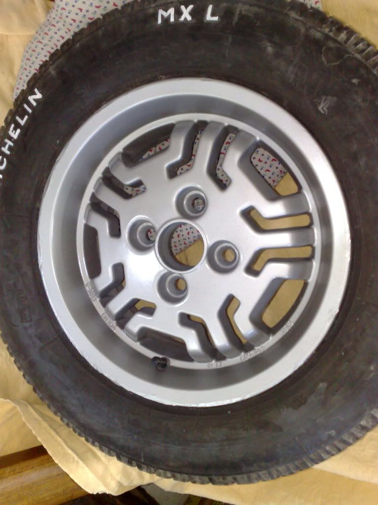

After i had primed the wheel i left it to dry and then started to apply the silver spray paint took about 4 coats before i was happy with it, then i moved on to laquer the wheel up because this gave it a good and strong finish.
Heres the wheel after i had finished, ignore the cheese white writing on the tyre i was bored lol.
Anyways i am well chuffed with the final product and cant wait to get started on the other four wheels, hopefully in time for retro rides.

To be honest with 600 grain wet/dry paper it took me about 30 mins to prep the wheel, so wasn't hard and that got the rim smooth and ready for the primer. The lacquer gave the wheels a real good smooth finish. Money wise it cost me about 20 odd quid for the materials and hopefully that'll last me for the other 4 wheels, if not ill grab some more.
