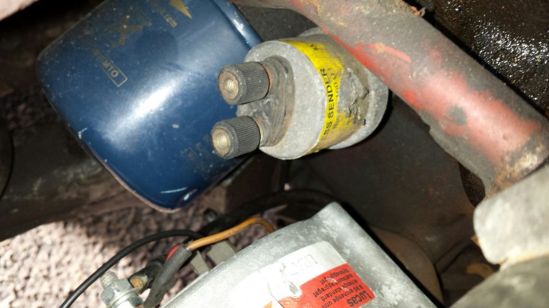

Okay on the alternator is it supposed to be just the red wire plugged into it ? Because I have a red and a black wire into the alternator but the black maybe for the pressure sender. This is what my sender looks like.

On mine the black wire goes onto the pressure sender but yours does not look like the standard one so probably you need to experiment with which terminal on the pressure sender the black wire should go onto.

You need to figure out what type of sender it is, it may have a simple warning light connection and a variable output or just the variable output. I suspect it is 2 terminal variable output only, so it won't drive the light directly.
Alternatively you could just get a replacement simple sender.

Figured out it is a 2 terminal variable output only so going to buy one that is a warning light connection and a variable output. So the light can turn off and so i can have an actual oil pressure gauge, thanks for the help!
