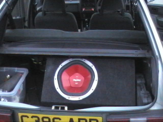

hey guys
Well Since I Have A New Install I'll Give U some Pics Hope U Like Cheers Josh
cheers guys
