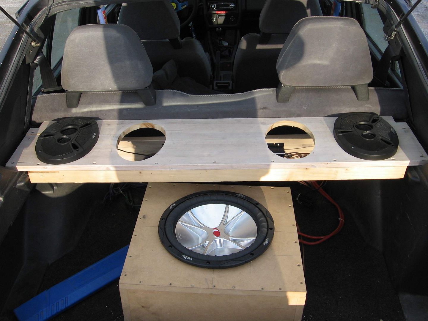

As Chris said, you have to cut the panels. But take them out first! Might sound bloody obvious but I know someone who tried to do something similar with the panels still attached.....
Pull the panels out, use a template to cut the holes and make a spacer up, and then screw the spacer into the body and the speakers into that. It's not much work really. Maybe a couple hours all up.
You will also have to run cables through from the front which is a little fun, but easier than most cars. The rear seat is simple to pull out which helps.
Mine ended up like this
