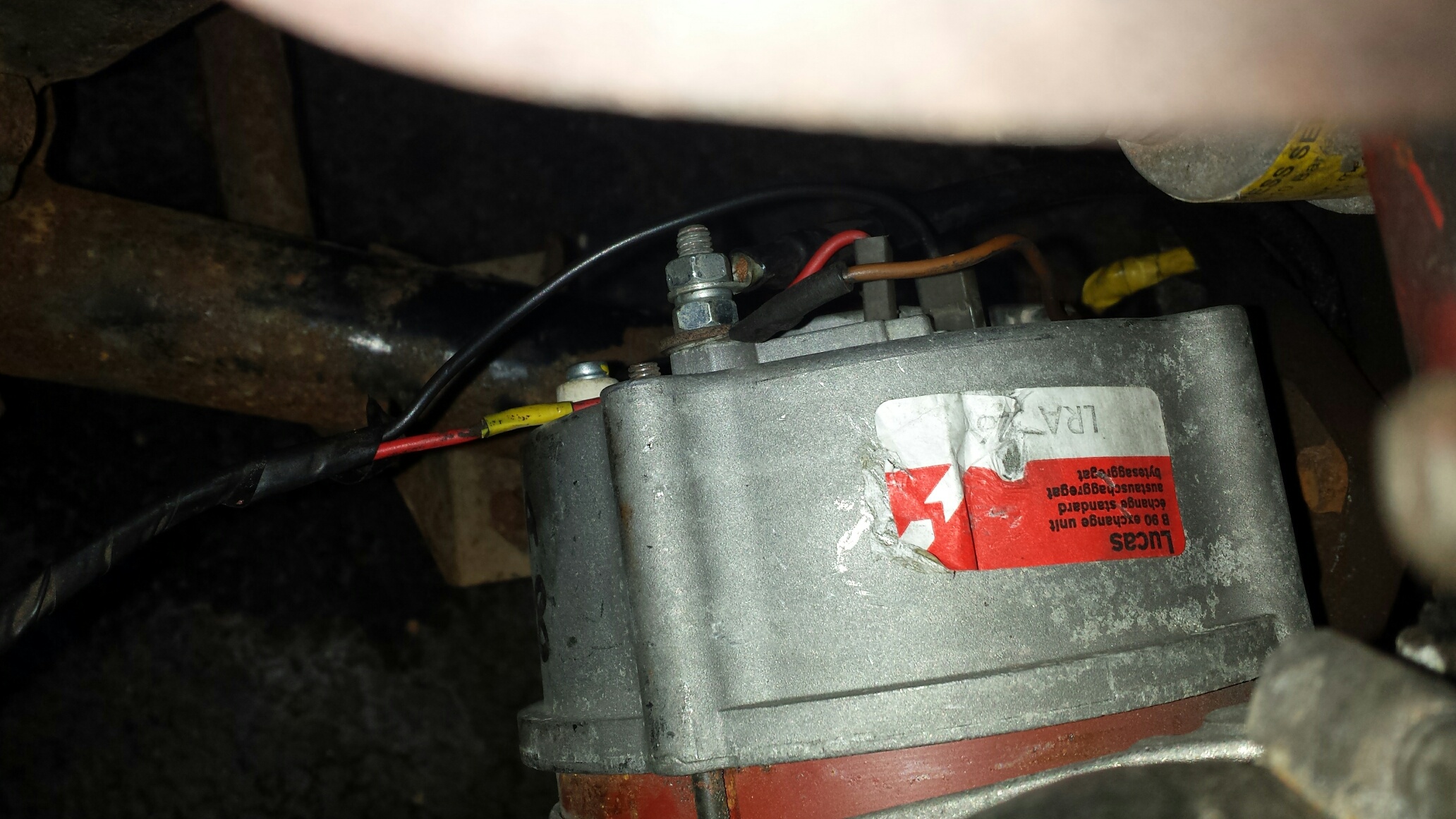

And here's my alternator if you look at it red and black wire come out same way from loom. but I have red and black wire attached to alternator. Is that black wire supposed to be on the alternator or pressure sender. Thanks
Re: Oil light
On mine the black wire goes onto the pressure sender but yours does not look like the standard one so probably you need to experiment with which terminal on the pressure sender the black wire should go onto.

Re: Oil light
Okay so the black wire shouldn't be hooked to my alternator? Got it will take it off when I get home from work and tinker with it.
