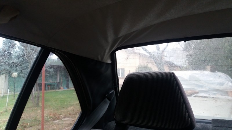

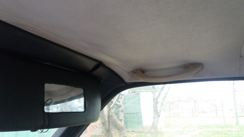

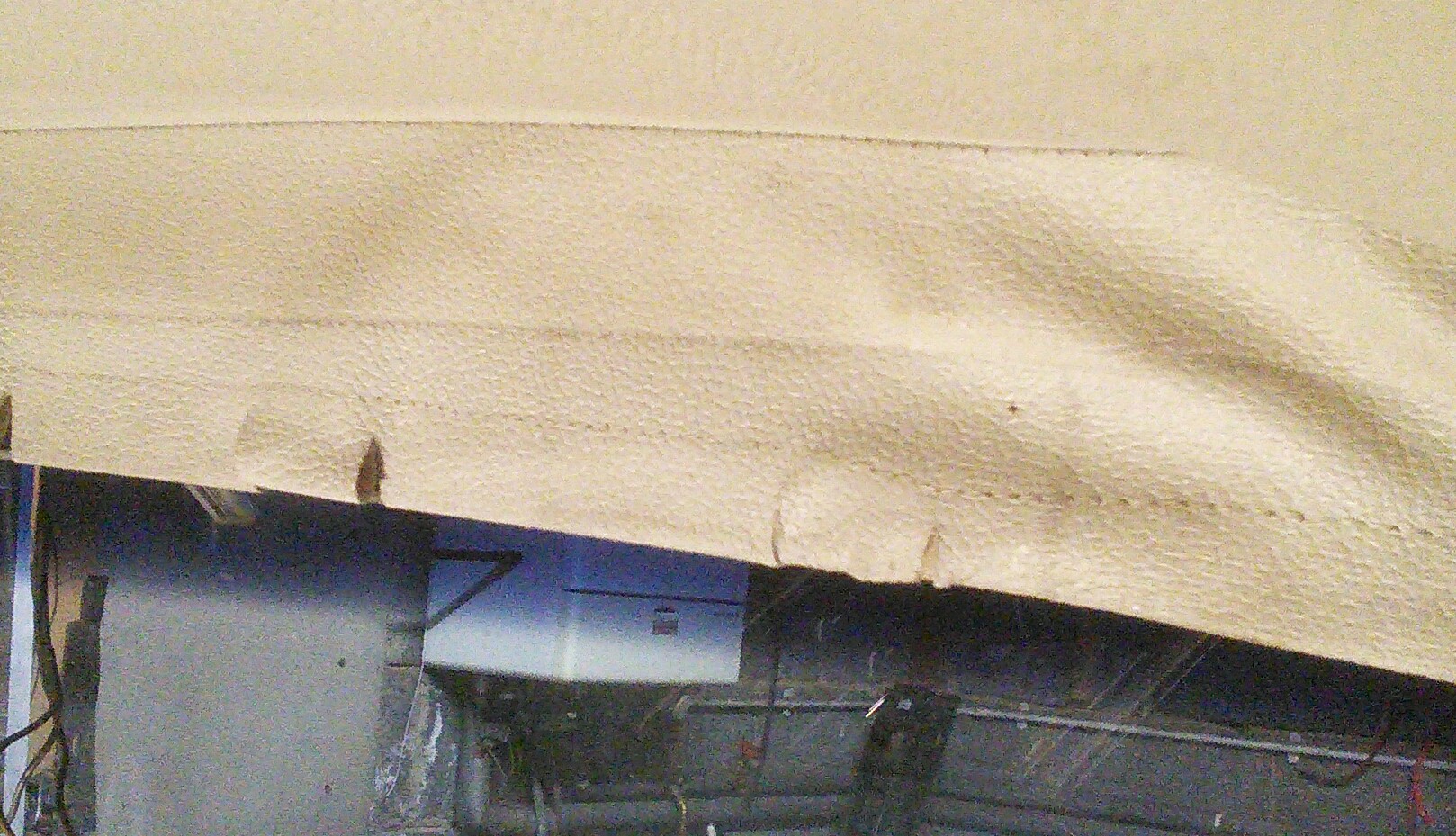

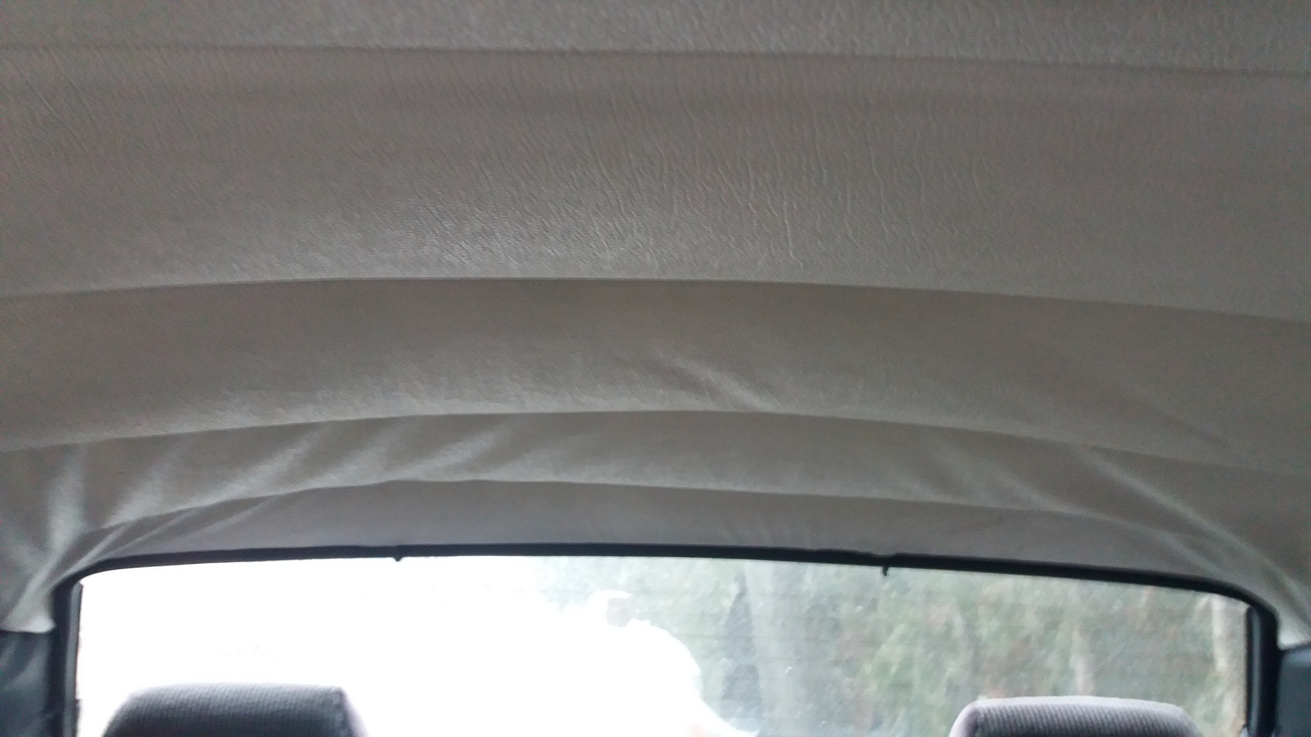

Thanks Ride_on, I saw your reply after posting back in the summer but I forgot to take pictures and upload them. So, my sedan had a factory sunroof until I have decided that it has to come off - it was too rusted, and the previous owner of the car had broken some of the components. This year i saw in a auto scrap a 340 5 door, and this was my donor for the interior lining, and some other parts. Indeed, in the back/ on the C pillar i had to buy some black eco leather, and there is for sure room for improoving the way it looks.
