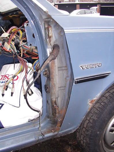

wing bolt locations
front
need to remove door to get to these ones

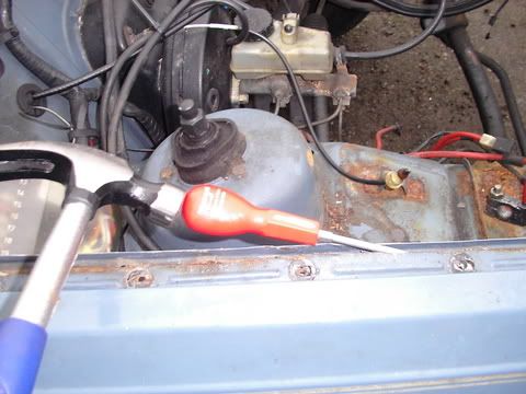

wheelarches....
wing tops
Ahead of front jacking point
loosen wing...sealed by volvo onto inner wing...

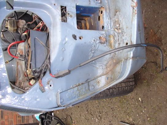

Inner wing
Once wing is off it is worth reprotecting the inner wing with waxoil type product.
The inner wing looks much worse in this pic than it actually is!! The oil/sealant used by volvo looks the same colour as rust!!
The only rust on this wing was where is meets the top of the wheelarch!

wing bolt locations
front
wheelarches....
wing tops
Inner wing

Oh i beg to differ on these ones mate!!! You can get to them with a 1/4 drive socket and ratchet mate. Having a wobbly ended extension (*insert puns here*) helps get over the bolt.shimon340 wrote: need to remove door to get to these ones

I stand corrected
I was told by some other volvo people that you need to remove the doors.... On this car it was a dismantle so I never got the chance to remove the wing with the door in place...

I was wondering about the door thing... a very un-typical volvo design that!!
