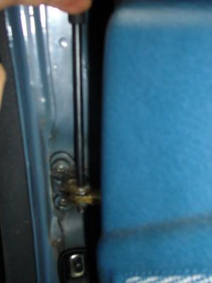

dya mean the one by the back of the wing? Either you can remove the allen bolts that hold it into the A pillar - but these might be rounded due to age... or you have to remove the pin as shown in the following pic. Here I used a Draper door pin removal tool. A light tap with a hammer should be enought to remove it.
on the 400s this pin wear quite fast and make the door make a pop pop sound as it opens.. fortunately the 300s dont suffer from this problem...

The tow loud pops are normally a knackered check strap, cured by removing and replacing, which with the door on is tricky, but achievable!
