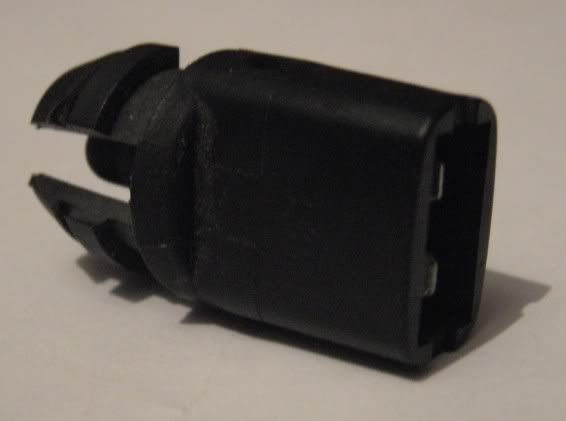

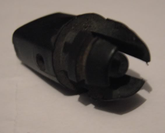

Hi James, if it's on a B200 take the tapping that goes into the engine from the vacuum hose, and fit the blanking stud from your own to replace it. The vacuum hose as well, and for the ambient temp sensor, your car should, however I won't guarantee it due to the way Volvo didn't appear to do the same thing on every 300, have a wiring loom for the ambient temp sensor hidden under the air filter box in a bundle, with a plug on the end, so all you need is the actual sensor, which if you remove the bumper cover under the head light on the black part of the bumper on the drivers side, you'll see the sensor inside there and you'll be able to trace it on the other side of the box section, it is literally clipped in. However if you want to be sure, trace the wiring up to the back of the dash and take that too.
The Sensor......

I remember Chris telling me about the sensor at the BKV meet last year, went back to the breakers today and pulled the full consul, the sensor and anything else that I could see related to it, the car it came from was a Blue Line which looked nice from a distance but not so good close up.
I now have a good idea of what to do to re-fit it all to mine. The only stuff I am going to have to work out is the vacuum tube you have said about, as all the parts have come from a 1.7 and my 360 is a B200E. I wont be fitting them for a few weeks as I am away with work but will update when back.
