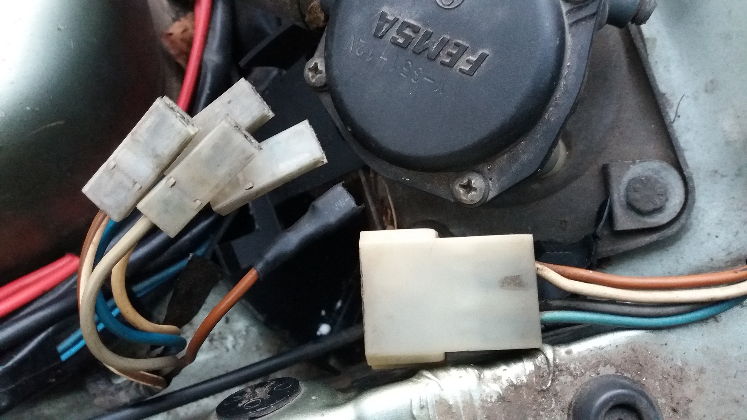

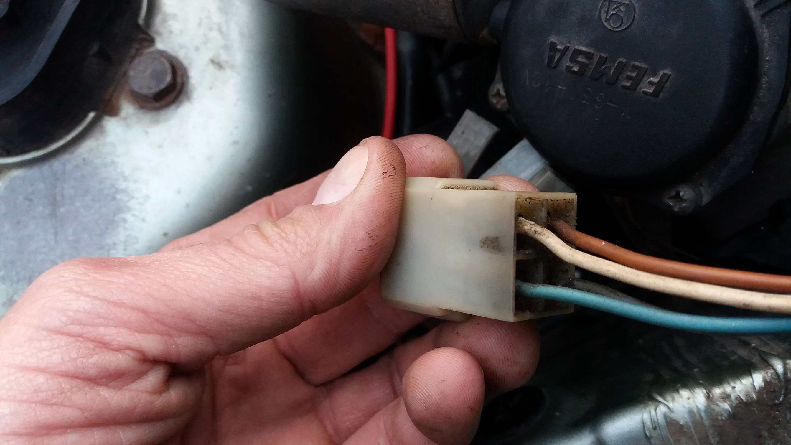

Hello! I will post here, because i don`t want to start a new topic: last year I took the windscreen motor wiper out from the engine bay without making a photo to the wires
( since then i`ve had just one speed of the wiper, without the intermittent function by connecting the white wires together). From the main loom there are 5 wires, from the motor there are 4...By connecting the wires blue- blue, white-white, i ended up by blowing the fuse. I don`t remember if i had dismantled the engine, i saw what pettaw sad onto another topic a few years back:
Thanks.pettaw wrote:I'm 90% sure its the motor. One of the contacts has a permanent live and there is a cam in there that operates the motor until the cam closes the contacts. That ensures the wipers always park in the correct position. If you're getting operation by itself that's where I'd look.
