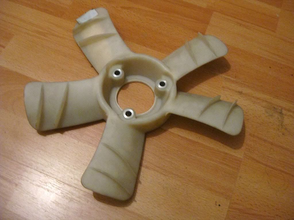

Volvo recommended fitting an extra fan when towing, IIRC it was bolted to the water pump? It looked like this:
Other than that, enjoy your caravan! A Volvo's natural realm ;-)

That would have been very usefull! Was that just for the older models with the fan driven off the fan belt of could it also be fitted to the later electric fan models too? I'm wondering if a second electric fan would be an idea on my 1.7 with a manual switch in case of overheating, or would this be overkill as the more power full engine should be straining less? I suppose in extreme weather 30C+ it could be good. If the engine ran hot I suppose the electric fan would come on anyway.

that fan is for the new type B14 coolant system only, it's a bolt on against the pulley and the electric fan is still able to kick in too. old type coolant system b14 models were factory equipped with a fan on the waterpump pulley and no electric fan.
