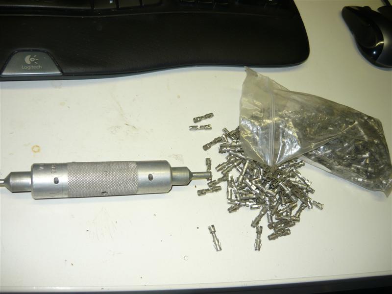

i have that tool for the round ones right here at my desk,
it is part no 9996351 "removing tool"
perhaps these wouldn't have been a problem if they didn't use 4mm² wire (but 2x 2,5² in seperate connectors) and didn't tigh the bundeled cables up that close to the connector, there is a lot of tension on it imo

there are 3 different tools for the electric connectors around the 300 series fusebox, and i have all 3 of them. the one mentioned above, i don't know if that will be available anymore but the 2 others definatly are, i'll sort some dimensions/part n.o. out soon
the thing you need for those rounded connectors is really simple though, just a hollow pipe made to custom dimensions on a lathe

Re: Dodgy electrics
ø5mm outer diameter; ø4,5mm inner diameter; that's all, the tool itself has a spring to press the connector out but with a pipe you can just pull the wire itself, no big deal:
note; these connectors still have a volvo part number!!, volvo still uses them for certain connectors
Re: Dodgy electrics
Update...
Dealers certainly can't get hold of the tool, but making one now I have Anjo's specs is really easy.
Anjo, do you have said part number for a bag of crimps bud? All the usual suspects (WVP, Simtek, Autospark, PoleVault) don't seem to list them.

Re: Dodgy electrics
i believe that they are from AMP, problem is that i can only look up the Terberg partnumber, the original Volvo number it corresponds to isn't listed anymore..
i could look up the other 2 tools this week if i get the chance, those are definatly commonly available as i recently got one of them new from Stahlwille; we use those for a wide variety of connectors, kinda universal tool
