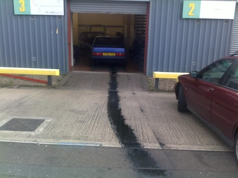

Post by filthyjohn » 13 Nov 2009 03:37 pm
Results of high revs on 9mm rods:

Post by Fuse » 05 Dec 2009 12:51 pm
filthyjohn wrote:Results of high revs on 9mm rods:
Stav2 wrote:Cheers for the info, didnt realise it had the rubbish robs, damnit :lol:
No it doesn't have... B200 has weaker 9mm rods, B19 is different.
B19 has "M" -rods which are even a bit stronger than the later model 13mm B2x0 rods so that wouldn't be a problem in this case.
But if your engine is B200 then it has the weaker rods.
