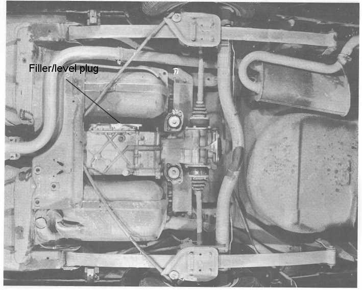

here is a picture with the underneath of a 360, this is a fuel injected model and on the right side of the car, the 3 bolts in triangle shape are mounts of the fuel pump, which you don't have, probably behind that spot are your fuel lines.

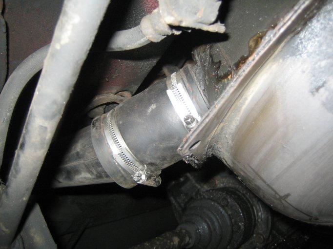

Here you can see the usual place where leaks occour on 300 series

Thanks Kalyyyyyy for the photos, I think the underside of the car is similar to that of an injection type but there is a fuel pump at the tank in the injection one, isn't there?
As for the last picture I don't think the leak is there because the tank hasn't really had even a half load of petrol since December, and since I've noticed that I'm losing fuel I've just had it after the second line on the fuel gauge so that I wouldn't lose to much fuel :(
