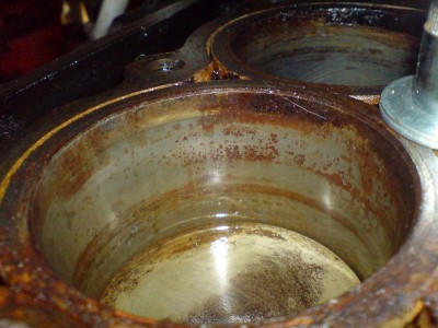

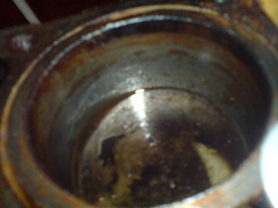

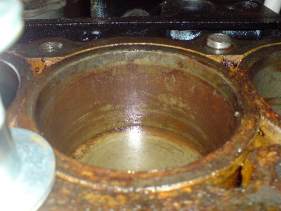

i have had a mostly complete b14 engine in my garage for a while and thought i'd find out if it would run again. sadly i used its cylinder head for my old 340 and its sat headless for about 18 months out of the rain covered with a bin liner. it was seized but after a week under hydraulic fluid and a few sharp hits with a hammer/wooden block its freely moving again - with the engine secured you can crank it over and over and over with a ratchet.
anyway before i spend upwards of £3 on a replacement timing cover gasket i wonder if anyone has an opinions on the state of the bores. marvel at the 3mp quality of an old mobile phone.

so question is - can this rust be honed out without needing to get oversized pistons and liners and other things that aren't available anymore?

looks like surface rust but you won't know untill you hone it..

pistons 1 and 4 (sat much lower in the bores) were in much better shape than the less exposed middle pair which puzzled me.
even so i'll get a honing drill device (unless they're useless?) and see what it ends up like.

i'm not going to hone the cylinders, the rust is very light and the bores are in good condition otherwise. i'll live with the marginal loss in compression given its going to be used for a project and doesn't have to be reliable or fast at all.
