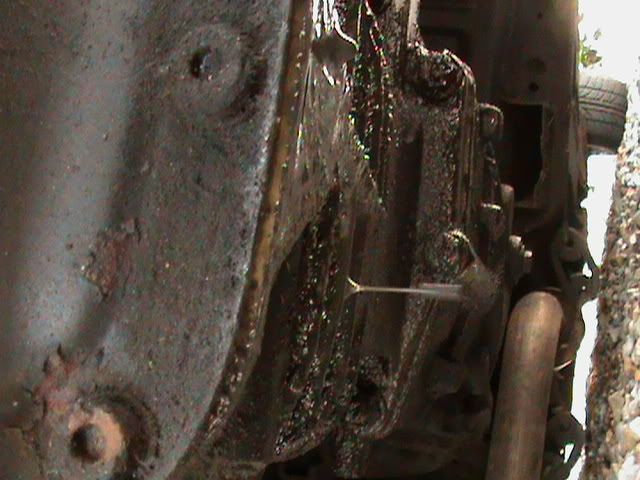

If the diff is leaking you can bet it'll be low on oil level so check and top up asap and then get a gasket kit from Mac when you get a chance, but top up first, because the diff doesn't hold much oil, 2 iitres approx, it doesn't have to leak much to get dangerously low.

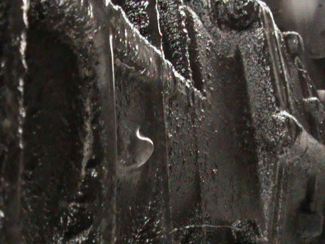

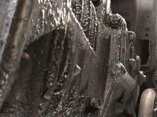

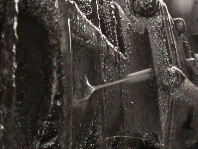

lol @SteveP. Nah you'll have to find a new diff mate. I bet one of the weld blobs has separated from the spider gear, gone whizzing round the casing and destroyed half the stuff in there, and even if it hasn't the fact that one weld blob has come off means that the others won't be far behind.

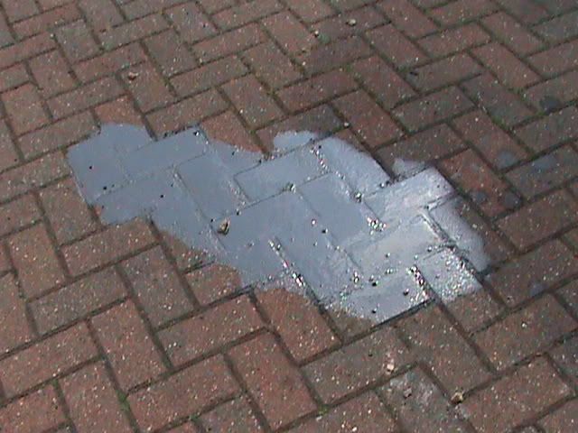

i think pettaw may have it correct, i drove it today and thought the diff was not locked properly, felt like a mild bit of play but i only think that because it was not scrubbing that much on full lock.
glad it went on my driveway rather than me driving it and locking up on me!.
