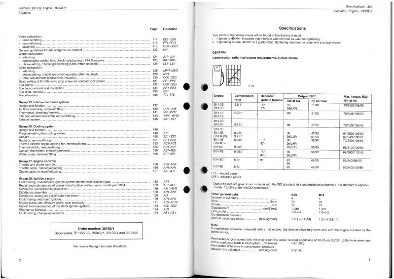

Just to confirm, volvodspec, you were running a B14 4E with a 402 Renix on a CVT car on 95 octane unleaded with no issues of pinking? No C plug earthing at all?

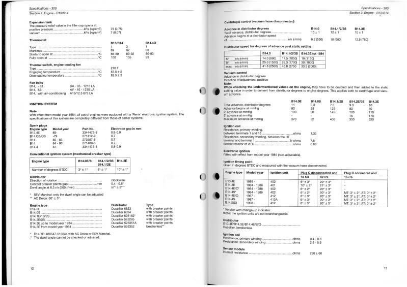

I'm going to update the volvo300club post with some scan from some various books etc for discussion. Some extra B14 types in there as well. Seems the conversation in english is ok so long as we're still talking tech stuff!
Given the info to date, a manual B14 4E with a 402 Renix with no amendments to the C plug, shouldn't run well on 95 octane unleaded. Not saying yours didnt but given the tech info so far it shouldnt have been ok.
There might be a curious fact the CVTs had different ignition timing to the manuals (more advanced maps). Can't see a reason for that at the moment though as to why volvo would specify the manuals and CVT maps differently.

Can anyone clarify why it seems to show the AT (=CVT?) having a more advanced map than the MT cars?

anyone know why the Volvo green books seem to show the AT (CVT?) as having a more advanced map than the MT cars on unleaded.
I'm guessing AT = Auto transmission. Any other suggestions?
