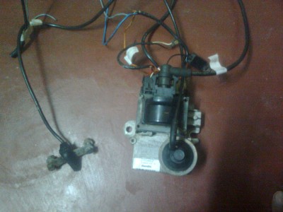

i need to wire the renix 412 my volvo 340 1.4 (dont have any previous wires to connection )so i need some help to fix it

So you have the Renix flywheel fitted and just need to do the wiring?

there is nothing near the wiper motor
what is that part?

Hi Shamil, the picture of the conversion shows a renix and a coil near the wiper motor. You should have all the bits.
Please remind me what model / year is it you are fitting it to again?
Can you post pictures? If not, you can email them to me:

a) The distributor should fit only one way. It is located by 2 pins, see THIS THREAD. Timing can be checked with a strobe lamp (with the vacuum capsule on the Renix disconnected), but cannot be adjusted. It does not need to be adjusted as the engine position is read by the crankshaft timing sensor. (The flywheel should have a timing pattern on the edge of it). This page might be some help: Volvo Forum Repairs - 300 Renixshamil wrote:Sorry I was busy. Thank you very much for posting the diagram. The prevous owner had removed the entire Renix unit replaced it with some other ignition system.
Mark sent me the Renix unit (including all the wiring), distributor, plug wires. Now I want to fix it.
My questions are:
a. How do i keep the ignition timing
b. What is the part mention in diagram D9 (Do i need it?)
Thank you for helping me
b) The part on the second picture (P29) marked D9 and inside box "F" is just the ignition key switch on the steering column. (Note: diagram shows LHD car).
Any references to AT in the Volvo Green Books refers to Automatic Transmission.shamil wrote:...I would like to know what is the AT vacum control unit?
