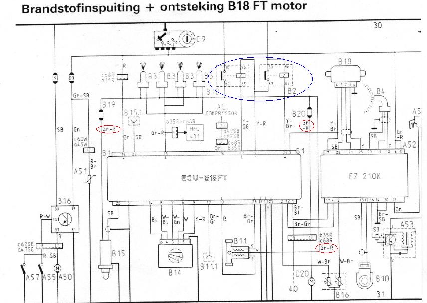

Hi!
I have made a b18ft engined 360. So I could help you a bit.
First of all the grey-red wires are switched + by the 2 main relays (near the ECU).
Idle motor, O2 sensor, injectors...
Gray can be after ignition +.
But the red wire could be the third pin for idle motor (if it goes to ECU pin 10)...
If you want some pics, please send pm.

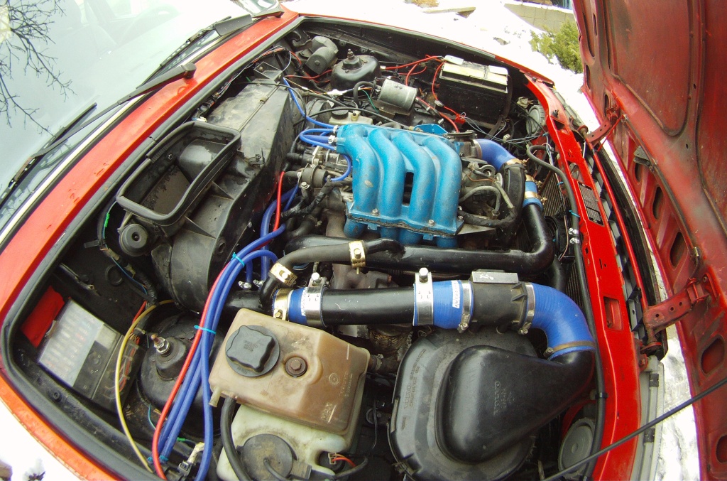

by jezypeti » 16 Jan 2013 12:41 pm
Pics of the enginebay. Sorry for gopro.
I dont think, this would help you...
If you are interested in some details, please ask!

by Chris_C » 16 Jan 2013 02:35 pm
I wish my B18ft not done project was left hand drive!
Good use of the 360 air box too.

by theashboi » 16 Jan 2013 06:34 pm
Pics don't help my engine bay looks a lot different
I will take sum pics when I get home later it is just sum wiring to do and it shod start the pump and sender are in the tank fuel lines are in rad pipes and oil are dun along with the throttle and new starter motor just need the little bit of wiring left so frustrating

by jezypeti » 16 Jan 2013 10:23 pm
For startermotor, you can use the stock wiring harness (blue-yellow wire I think). And you need only connect it to the battery too.
Right hand drive... I couldnt drive from there
I'm witing for pics.
(It was 360, so I have the battery tray in good location. And the air box is stock

by T.J. » 25 Jan 2013 10:02 am
you have been busy
I see fuel lines and all the water hoses are done.
The coiled up wires coming from the alternator should be for the old 480 infocentre, so hopefully you can just cut them off. The 3 (blue/orange/white) are for the original ignition coil.. just look it up in the haynes book
Trundle returns... Watch this space
