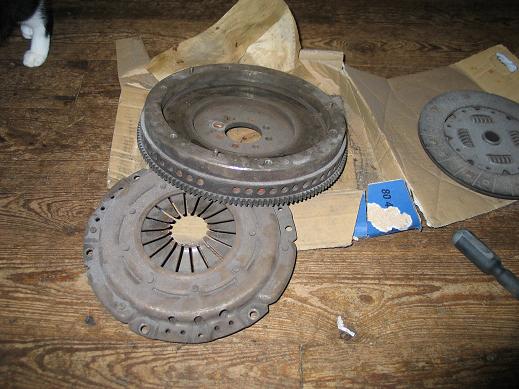

Hi guys tried to search but not much use - anyone know the part number that's on a dogdish flywheel? I've got a b230ft from a 940 but that came with a dual mass - mum just received a flywheel I bought off a 2lt manual 940 in the post. Can anyone confirm if this will do the job/give me a part number so I can check when I finish work
Thanks all!

If you want to use the 940 ignition then you need any EZK flywheel (sometimes referred to as a LH flywheel), with 2 missing timing holes (60-2 pattern I think, 58 holes + 2 missing).
This is what I was given for my 360 project. Haven't tested it yet. No part number on it, came with a 230 mm clutch plate. There are various sizes.
So any EZK trigger pattern non-dualmass B2xx flywheel will do.
I actually like the 360 renix flywheel because the engine starts instantly, the 940 has to get past TDC before it will fire.
