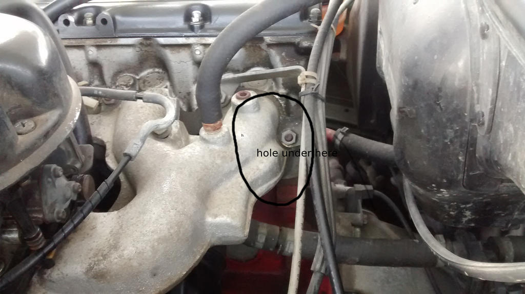

Thanks guys for the replies, there is a little confusion about different water ports. the second photo shows a B200E head without manifold, there are 4 water ports along the side of the head. The first one, working from the front of the head, is blanked off with a frostplug, the second one is the temp sender for the temp gauge, the third one is one of the sensors for the EFI, the forth one is the other sensor for the EFI.
The B200K head has all these ports also, the first one is one of the ports for the heated manifold, the second is again the temp gauge sender unit, the third is blanked off with a plug, the forth one is the second port for the heated mainfold.
the first photo shows the B200K head. The circle I have drawn on the photo shows where the 4th port is under the manifold.
What I am hoping is that 4th hole is actually threaded to allow the EFI sensor to screw in.
The first hole will have to be blanked off with a frost plug as in the B200E head.
IF they went to the trouble of threading and blanking the third hole on the carb head instead of just leaving it plain and using a frostplug then I am hoping that they did the same for the forth hole?

OK, now I have the head off the motor, for anyone else wondering, the carb head does not have the threads in the holes that the injected head has, meaning without expensive machining you can not bolt on a EFI inlet manifold to a carb head, you really need to use the EFI head complete.
