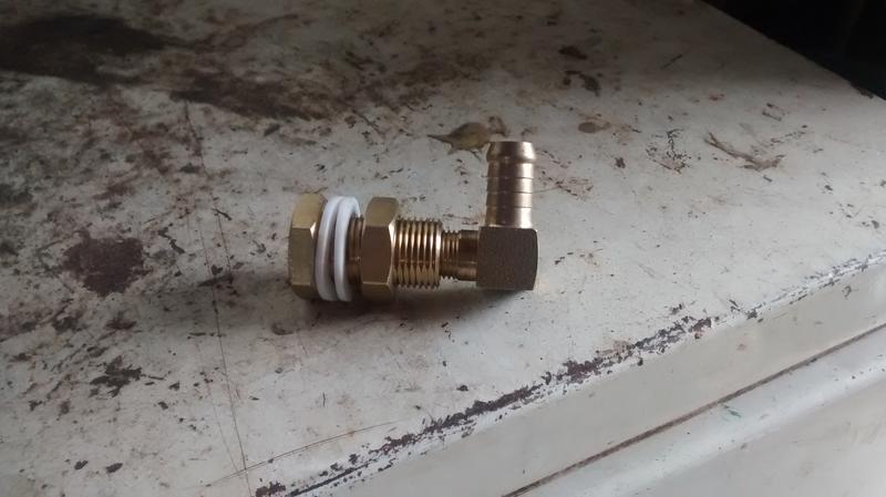

I think I have found a way, I am going to drill a 20mm hole in the tank, directly underneath the fuel sender and use a brass bulkhead fitting with a 1/2" hose from that to the fuel pump. I will use the original feed pipe that goes to the existing mechanical fuel pump as the return line back to the tank
Re: carb to injection
I would say that will sort the flow issue, but you don't want to be too close to the bottom of the tank and you should have a gauze filter in the tank.

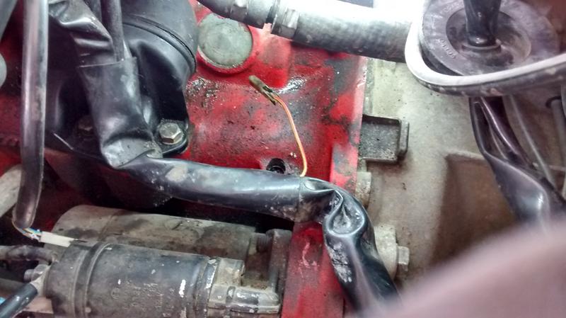

ok, i have finally started the conversion, well almost finished it now. But I have a issue, when I stripped the doner car I was carefull to label all the electrical connecters, all good untill putting the loom into my car this morning, I have one wire that either I missed labeling or the label came off.
It is a single wire, yellow with 2 red tracers, ( or red with 2 yellow tracers, it is hard to tell.) It comes out of the EFI loom roughly above the starter motor/bellhousing area
Can someone with an EFI car have a look and tell me what it connects to?, there appears to be nothing handy for it to plug into.

it's not connected to anything, i believe it's for a diagnostics tool but i'll have to look that up later

Thanks, that is a load off my mind, now all I have to do is pull the head off again and replace the seal on top of the water pump that I forgot to renew when I had the head off yesterday, What a dummy, I just forgot all about it and coolant just hosed out as soon as I refilled the radiator. oh well, live and learn I suppose.
