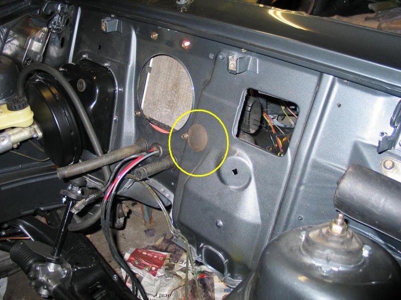

It seems my carb model has a small 30mm unused hole in the bulkheah. From memory this is where the injection loom goes, which needs about 55mm.
Anyone know what size it is and/or provide a photo of the location? I'm going to have to order a hole cutter.

The original injection loom goes through the bulkhead a bit lower near the heaterbox. Oh crap.. you have the steering on the wrong side, so maybe they flipped everything around and it goes through the bulkhead somewhere else?

I have just taken a loom out and it does go through under the heater box. On non efi cars a full grommet is in the hole

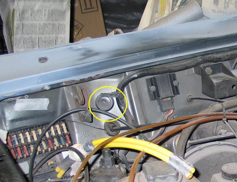

Ah! is it this;
Re: Injection wiring grommet
That should be the one, so they did move the hole in the bulkhead.
it overlaps >50% with the air box although there is a bit of clearance. Hopefully works, saves me cutting holes. Lets see if I can get LH2.4+EZK through it.
LH2.4 harness goes through, you can even use the grommet on the harnessRide_on wrote:it overlaps >50% with the air box although there is a bit of clearance. Hopefully works, saves me cutting holes. Lets see if I can get LH2.4+EZK through it.

I've got a full 940 loom going through there. So it does fit. I had to extend plugs so I lopped the big ones like afm off though.

So I've used the GLT grommet and cut it in the middle. It fits over the connector.

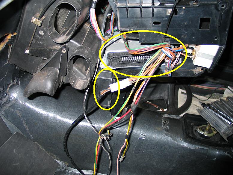

The 360 ecu goes behind the main support for the Centre of the dash, behind the little tunnel cubby hoke

^ yep, it does. Ali side facing the bulkhead with the connector on the bottom feeding the loom out to the passenger side
Thats useful thanks. There does seem to be some space there. The EZK bolts on where the 360 jetronic goes and the LH2.4 goes behind the ashtray. Just need to find the rear floor heater splitter to check if there is enough space as the pipes come round the ezk.
