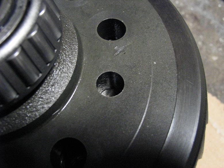

Looks like the diff module is not sitting flat on the crownwheel. In the process of cooking it now to remove (hopefully), then see whats going on.
I'm measuring 15.6mm in one of the blind holes to 16.1mm in the other (back of crown to base of diff module). The 0.5mm difference!
Internals with flanges loosely in.
Flush at the bottom
0.5mm more at the bottom

Deeper in now but not there yet.
The diff module is the same size as best I can measure as the Volvo cage, although the edge is a little damaged.
The deeper reason for the problem is that (in my case at least) the insert for the crown wheel lifts the mating surface of the module and leaves a gap between the 2 parts around the bolts. The base of the diff module is full of (purposful) holes and quite weak to the bolt torque bending the outside edge against this insert.
The insert (came with the diff) is very smooth and the helical gears rotate against it halfway across the insert outside egde. It maybe designed to suck oil from the gap or not rotate against the less smooth mating surface of the crown wheel.
gap in bolt area
Either;
1. The insert is too high and needs shaved down or
2. Its not flush for some reason or
3. It is designed this way and a much lower torque is needed or
4. I need to shim the mating surface around the bolt holes and close the gap
