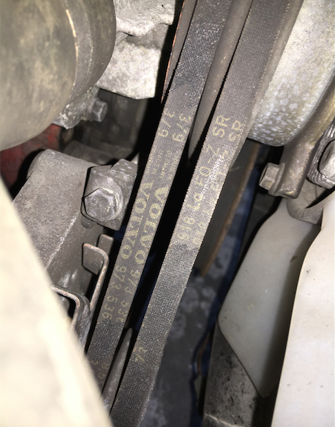

While on the subject, looking up old photos as my replacement belts have been squeeling since install, want to replace with correct parts. Only changed as they were on the verge of snapping. Seems the part number matches my original set, now to find some new ones

Re: Fan Belt spec
Hello. Is it tensioned correctly?
Re: Fan Belt spec
Hey Bog basic, when I got the car the pictured belts were in place. I didn't like the thought of them snapping so took one down to my local car shop and got as close a match as I could. Few problems, most likely wrong profile and they are not matched, as soon as I had them in place I knew it was not gonna be great, one is significantly tighter than the other, I wore the cost and just havnt got around to it, retensioning has helped but after a month or so I get my little start up squeal back :p have ordered a matched Volvo set from Dai so should be sweet soon
