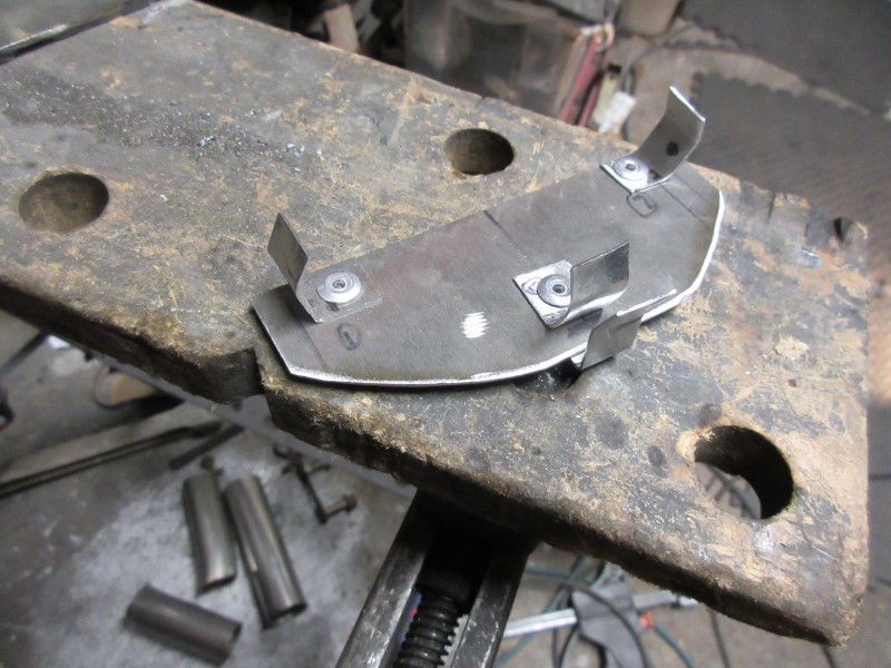

Added a cover to reduce the fuel sloshing out under braking, didn't make much difference.

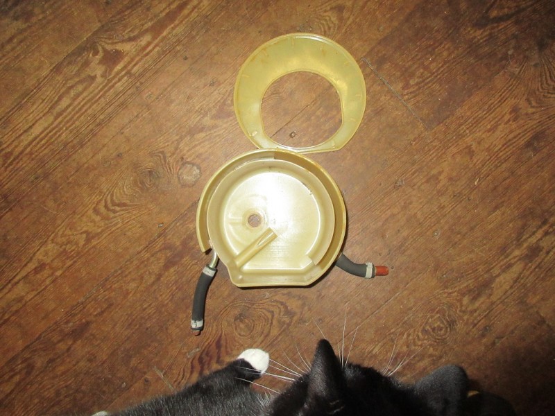

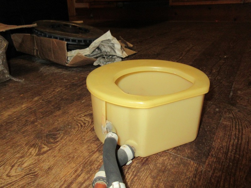

Swirlpot design, cat inpected
Broke off the outlet (sample was just for inspection)

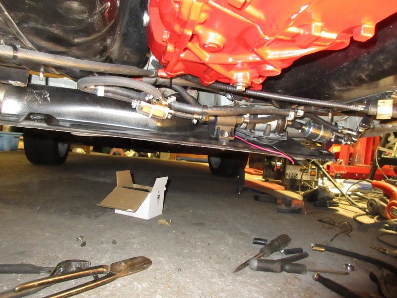

Added pump to try and keep fuel supply going to pump or feedback up into swirl pot. Injecting it between the pump and tank outlet, sourcing from the lobe joiner.
Helped a little.
