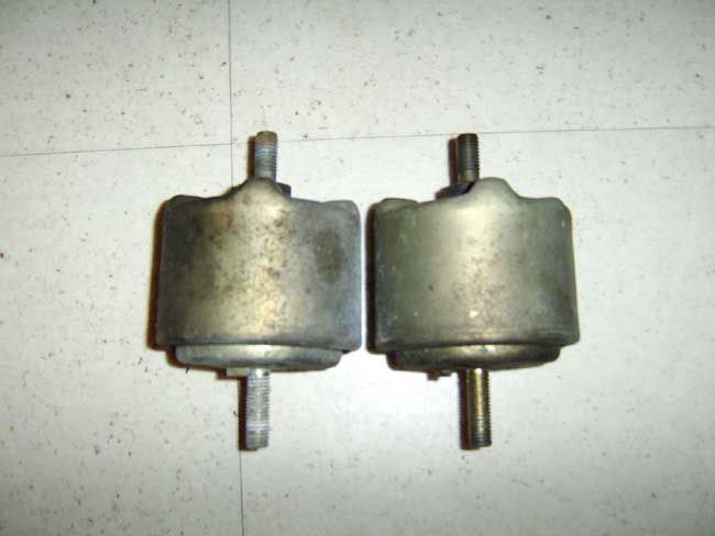

first and second engine mounts for two-litre
Post by mgarageu » 25 Sep 2006 08:21 pm
i have taken a picture of these now. seems to me it is too large...anyways i am trying to publish it here...
recently i bought 86 GL with B200K and replaced one of its engine mounts with another, which i took from my 83 GLT (parts donor car). in the middle of the job i decided to have these items photographed...maybe someone is interested...i also am going to make one custom mount to avoid further problems with these items...photos will be taken too...

trying another time to have acceptable pics...Image
antiekeradio
Posts: 697
Joined: 04 Jan 2004 10:53 am
Post by antiekeradio » 26 Sep 2006 10:06 pm
chrystal clear, thanks a lot!
looks like old/new style mounts can be made exchangeable by drilling some extra holes in the support.
never seen this type of rubber suspension before, makes sense though.

oh now I see the second picture..
8) the extra holes are already there 8)

Post by mgarageu » 26 Sep 2006 10:28 pm
i put away the older version steel hanger. used the new one, the older style mount and had to make some minor work on the alloy leg, which is between mount and engine block. the changes were about to avoid the mount to turn while doing the lower nut. sorry about my bad english - i simply cannot remember how the say about the place on the leg, which holds the mount not turning around...somethere else there are lock pins etc.
