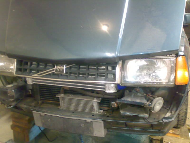

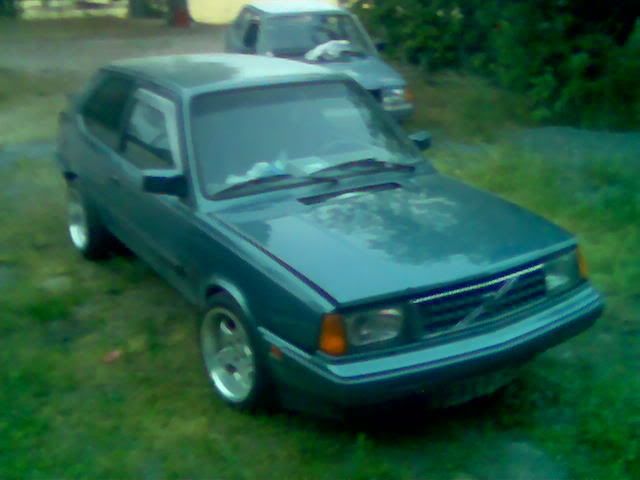

Well Makkiver is running over 300hp, +400Nm (B23, Holset HX40, ported 531 etc...
http://img.photobucket.com/albums/v605/ ... 1166639496 ) through that setup and it's holding fine, no signs of slipping.

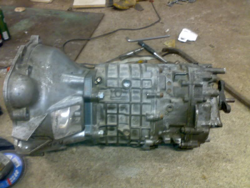

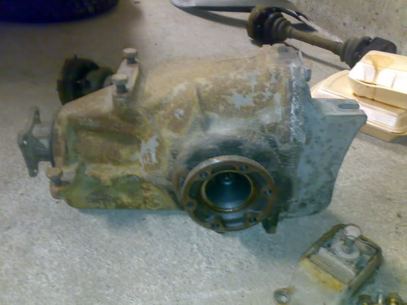

With "well enough" I meant that it will hold much more power than stock gearbox and diff can handle.
Half Time also had the same setup in his 360 and he went through couple gearboxes and diffs.. so there was some power involved.
Engine and the car are for sale, if I just had enough money..
