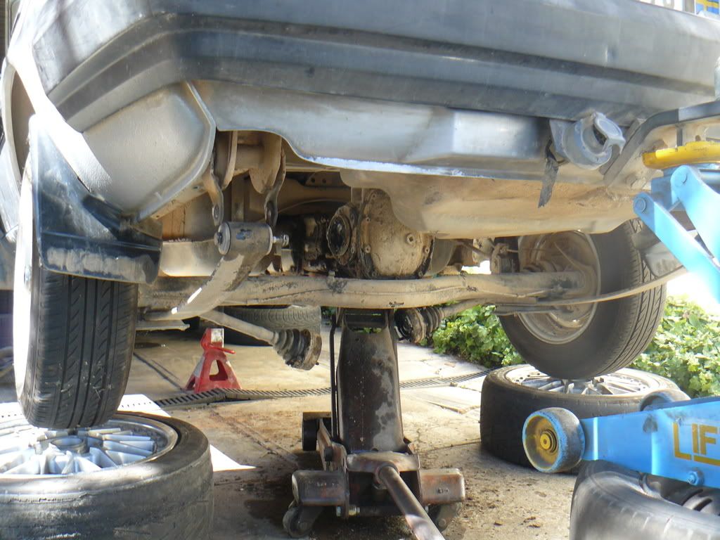

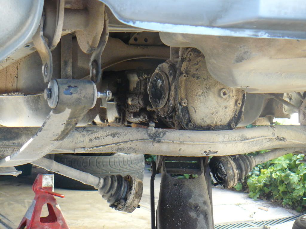

AND FUCK ME. HOW HARD IS IT TO CHANGE THE CLUTCH. some photos, and yes i am now taking the engine out. but seriously what a head fuck. and also a photo of my dedicated track car.
i almost got the prop shaft out but still need another inch or so. so gona take engine out as its just easier. gay gay gay
and this is what that car does - http://au.youtube.com/watch?v=cGLO0RIzLXI

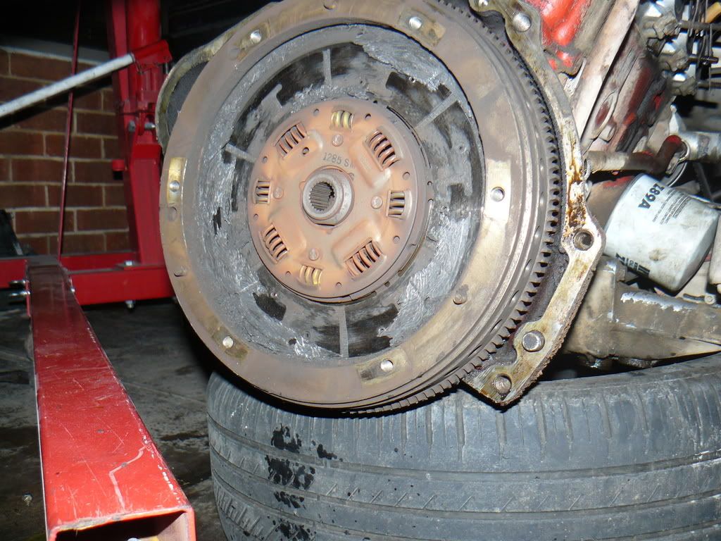

cheeze no one replys on this forum!

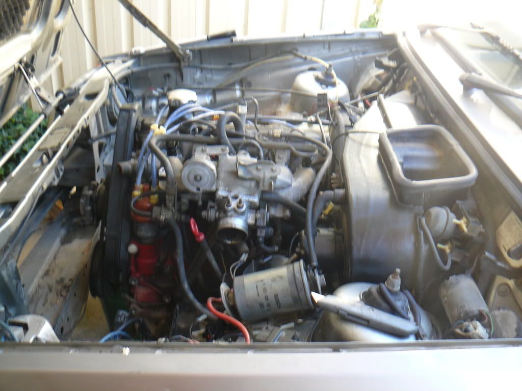

anyway, the issue. lucky it has not done this on the other side of the plate - so flywheel not fukt. If i do go through with this, i have found a place that will make me a custom ceramic brass button clutch for around the same price as i got quoted for a standard replacement item. but im not sure if there is any point getting a strong clutch if the drive line is weak as shit.

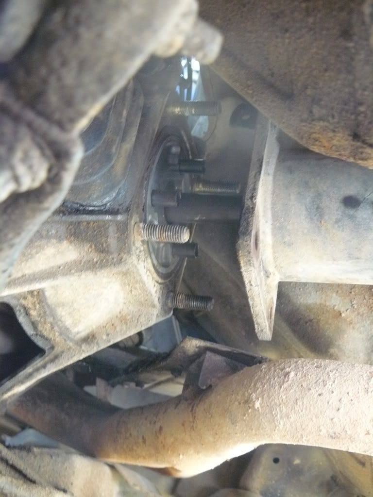

engine is now out with propshaft and gearbox and diff still attached to eachother. no idea how the propshaft comes out.

Re: Clutch always on after limiter action
I'm less than useful on 360 drivelines... but wtf caused that!? Has it stripped the rivets as well as taking the material off? The gearbox will see you to over 200, so I wouldn't stress about that too much.
Get it back together with a new clutch, as Chris says you shouldn't have much trouble around 200bhp, if you're worried about the diff you could weld it as they seem to be a bit stronger like that.
Clutch is indeed like a fuse in these, or at least better keep it that way, driveline is not very good for standing starts and burnouts, sensible time attacks on track is what it can handle pretty well with increased HP too.
