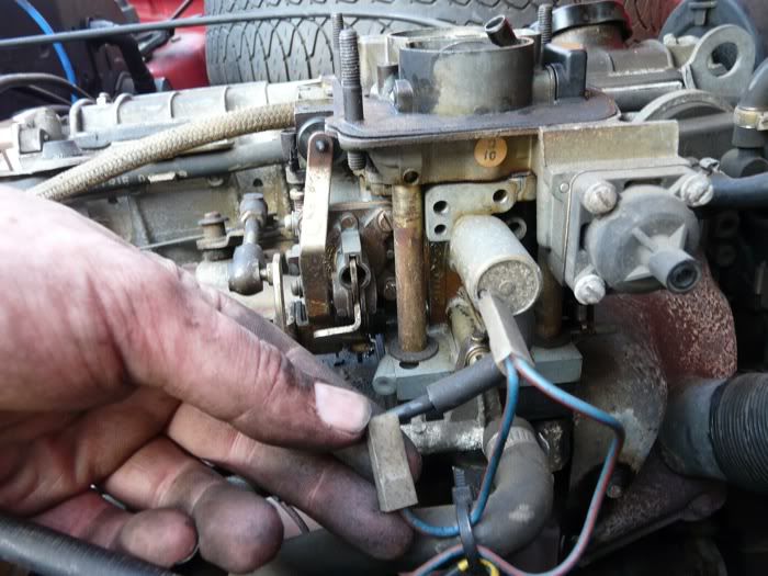

I also noticed last night that this wire isn't attached to anything, and looks like it should be.. Anyone know?
A long shot but worth asking I suppose.

yes, 1.4 and 1.7 bellhousings have the TDC sensor bolted with nut + bolt. special bolts though, m7 thread and a tight fit in bellhousing
that loose wire is for the carb pre-heater. should be attached at the base of your carb somewhere around the 2 coolant hoses, but not all solexes on the 1.7 have it..

If the carb has the water hoses in the base, then it shouldn't have the carb preheater, and vice versa. The water channels I believe are also for preheating rather than cooling.volvodspec wrote:that loose wire is for the carb pre-heater. should be attached at the base of your carb somewhere around the 2 coolant hoses, but not all solexes on the 1.7 have it..
What year is your car buddy, think the changeover was around 87

oh yes, that was it! cheers mate!Chris_C wrote:If the carb has the water hoses in the base, then it shouldn't have the carb preheater, and vice versa. The water channels I believe are also for preheating rather than cooling.volvodspec wrote:that loose wire is for the carb pre-heater. should be attached at the base of your carb somewhere around the 2 coolant hoses, but not all solexes on the 1.7 have it..
and btw, how dit they solve that on the waterpump? 2 plugs or something? or has the electric preheated version a different waterpump.. dawm it's a long time ago since i last worked on a 1.7

Cheers.. Car is an '88, should that have it?

Yeah it has the two hoses going into the base plate thing on the carb (just visible in teh above pic) and nowhere I could spot to attach any wires:)
Well, two hoses going into one hole anyways, via a junction piece.
