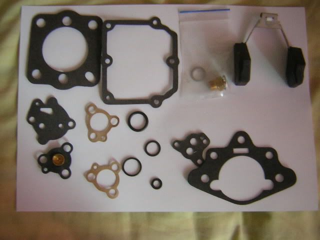

i has a toy!!
i dont recognise alot of the gaskets but im hoping it will become apparent when i take the carb off the car!

wtf, that's the wrong refurb kit
only the floater will come in handy i'm afraid..
Re: b200k running like a....
well its the wrong carb kit i got, but al the gaskets were intact and it cost me a quid so im not going to cry over it!
