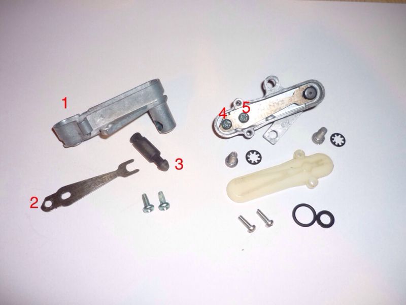

And now the finale -
The temperature compensator is probably the most mysterious and misunderstood component of a Z/S CDSE. It lurks under the white (but more probably dull amber) cover on one side of the main body and is part of the idle system.
The pic shows a dismantled unit and a complete one.
1. Is the main housing, 2. The bi-metallic strip, 3. The air valve plunger, 4. The strip securing screw and 5. The adjusting screw.
Broadly the unit sits in an air bypass channel with the plunger sealing the passage into the venturi - as the temperature rises the bi-metallic strip raises the plunger off its seat opening the passage progressively allowing air to pass "fine tuning" the idle mixture. The actual setting is a guarded secret and almost all publications (especially from Zenith Stromberg) advise leaving well alone!
However - the device frequently gums up and cannot be cleaned effectively without dismantling so -------------
Dismantle the device and ensure the plunger is clean and moves freely within the projecting nose of the main housing.
The bi-metallic strip should be absolutely flat - if not carefully straighten it. Engage the strip in the plunger and fit to the housing. Use a locking compound on the securing screw - ensuring the strip is centralised and the plunger moves freely up and down. Screw the adjustment screw in until the plunger just seals the housing nose.
Using a water bath and thermometer ensure the plunger just lifts off its seat at approximately 40-45C (if the valve is open at this temperature screw the adjustment screw in until the valve (plunger) just closes. Raise the water to 60C and ensure the valve is well open. Apply thread lock to the protruding threads of the adjusting screw on the underside of the main housing. (Yes, I know the Green Book suggests lift off at 20C but this seems to give a slightly weak idle mix)
The actual temperatures seem to vary depending on the vehicle and the source consulted but those given here seem to work well for the B19A.

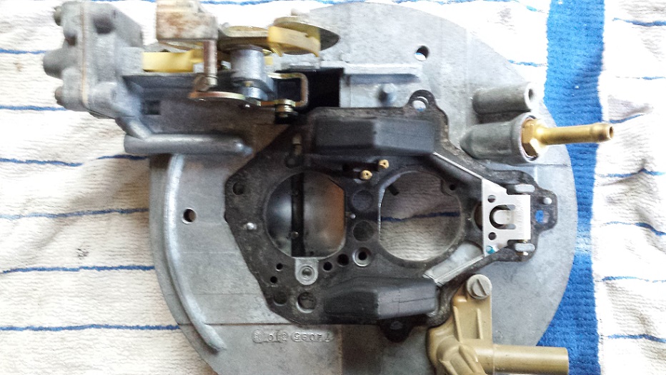

Currently I'm restoring my Solex CISAC 34-34 Z11 myself.
The base was warped and will be machined to make it flat again.
The float seems OK, but the main gasket has been demolished.

Thanks for your explanation. I indeed checked the float height with my Mitotoyu: 33.8mm
I'm in doubt about the 1mm gap between the choke cam and the top of the screw.
P.H. Olving manual says this gap should be 2.7mm as well as the pneumatic choke relief.
After many starting attempts, I ended up with an empty battery and completely soaked spark plugs.
I my opinion the CO mixture is far too rich. So I fully turned the CO screw to its limit (low CO).
The battery will be recharged overnight and I cleaned the spark plugs (Bosch WR7DC) with my USC.
New chances tomorrow! Oh, and the carburettor is a 1988 model, so no idle screw below the fuel cut off solenoid.
