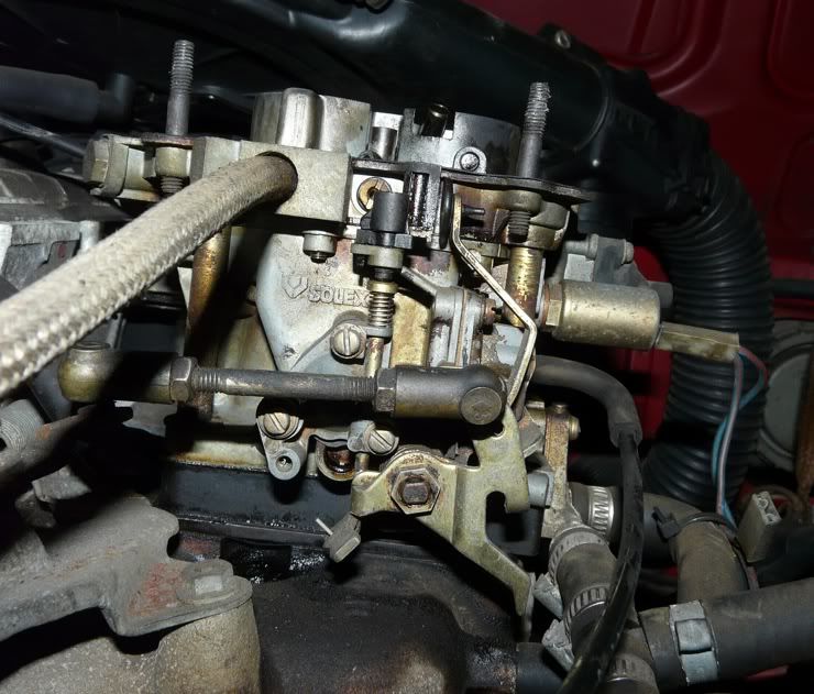

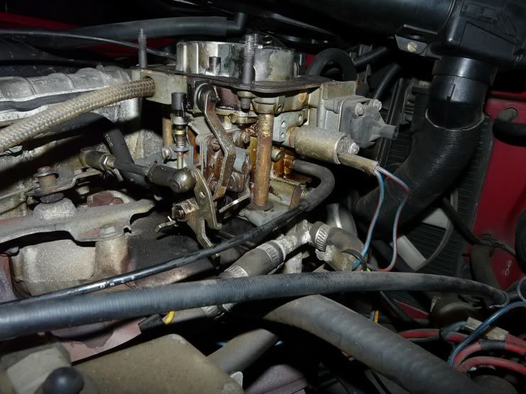

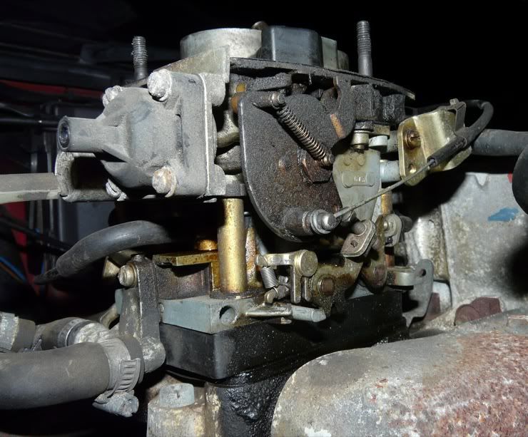

Can you grab a piccy mate. Memory is telling me the two hoses should be one each side of the plate, not a tpiece first... but mine has the electric preheater. We'll work out whats going on then... as I'm pretty certain 88 should be electric, hence you've had a replacement carb at some point, and it sounds like the preheater bits have been specialised.
Granted, all the above is just a punt at the mo, and I'm expecting someone to come along and tell me I'm wrong!

Cool, I'll go grab a few pics now...

Obviously its' dark out at 3 in teh morning, this is the best I could get... Do say if you want better ones or anything:D

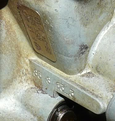

And I also got a couple of serial numbers.. I'll link these to save flooding the page with loads of pics.
72111 (V3) 0 (02)
85 8 63_3
I only noticed the brass plaque number when I checked the pics, or I'd have got a better photo..I think it starts with F 13 and ends in 28-34-2-10. Lemme know if it's needed and I'll check tomorrow.

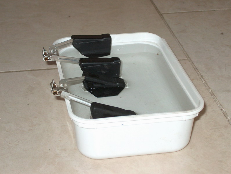

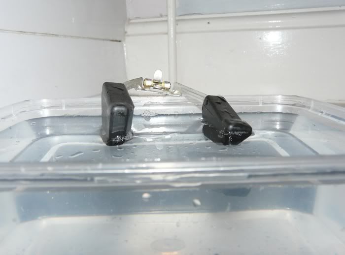

Floats are suspect!! One is way more floaty than the other... I'll upload a pic now so you can see how they are...
Re: 1.7 340 not starting...... Any help appreciated!
Post by volvodspec » 04 Jun 2009 08:53 pm
Jonofdoom wrote:Floats are suspect!! One is way more floaty than the other... I'll upload a pic now so you can see how they are...
then it's simple: order new floater from a renault or volvo dealer mentioning your carb number (maybe someone on this forum will have the number for the floater & a place to order it) make sure you adjust the floaterheight before bolting the floaterchambercover back tot the carb!

Heres the lopsided float:
The fuel cut off valve thing works, I tested it by blowing through it.. Another float will be ordered ASAP!!

woow whahahaahahhaa that floater is cool :D
no seriously, i'm sorry mate couldn't control myself :lol:
