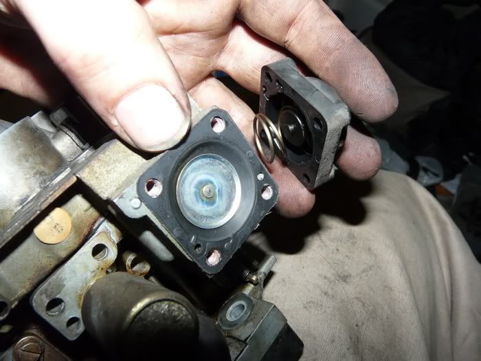

`Ahh I think I see what you mean.. WIll have a peek now:D
Re: 1.7 340 not starting...... Any help appreciated!
This thing by my thumb?
It seems ok, as does the gasket:)

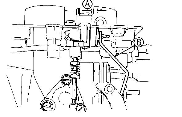

back again, this will help you i'm sure!
this is how you adjust the floaterheigt: bend lip B so that size A will be 33,8mm.
also check the floaterchamber breather, distance A should be 2/3mm without applying throttle! if needed, adjust lever B the "membrames" are at numbers: 11 - accelerationpart membrame
5 - partial load membrame
next to the idle jet on 4 i believe the 3rd membrame is located, and that will probably be for the pneumatic choke mechanism like the weber 32 dir has, don't know that for sure though
ah cool! you found it allready
best way to check it is to carefully completely remove the membrame, and moving the center of the membrame to the other side (the axial action the membrame performes), this way you can see if any tiny holes etc are present.
