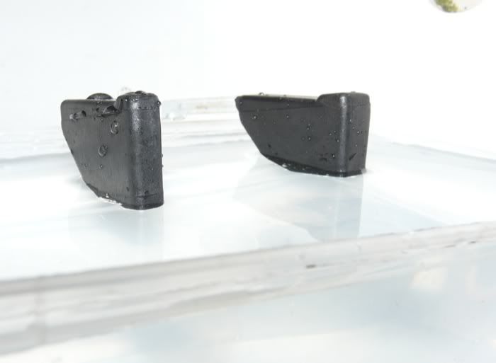

Webcon UK delivered:D
That's very impressive.. I didn't think I'd get it today:D:D
Gonna go give it a try in a bit... Touch wood....
Re: 1.7 340 not starting...... Any help appreciated!
Now THAT"S a floater:D
EDIT: I notice it looks a little lopsided in the pic, that's not the case in reality, this really is a frikin nice floater:D

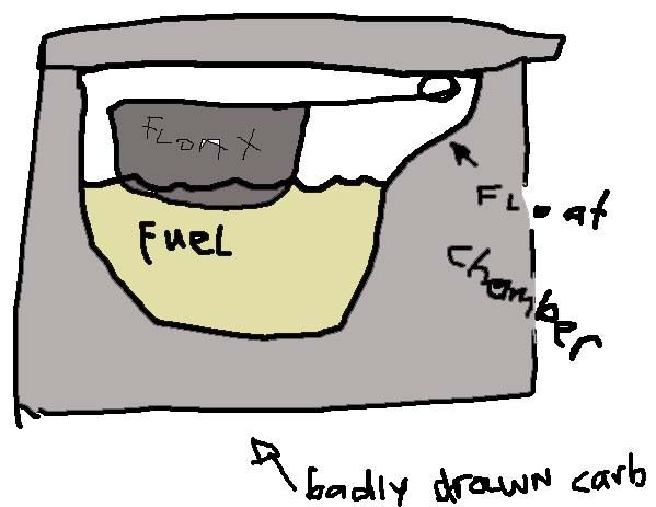

So yeah, anyhows.. I checked for sparks one last time and its' all good, some wet on the plugs though I think, and the (brand new) plugs have gone real black with soot already. Checked for fuel in the float chamber, its' there.. Not as high in the chamber as before the new float, about this high, maybe a touch lower, it's not a very good pic:
Yeah, I realize now it would've been much easier to just go outside and take a pic!!
So basically I must've done something to the carb while it was off, but I've NO idea what. Arrrgh god, this is frustrating.

fuel level seems ok in pic
mixture setting sounds wrong, maybe due to the leak floater someone has been fiddling around with it.
reset idle screw (reached trough the hole in the air filter housing) to make it run, then take her to a garage and reset the CO levels.
