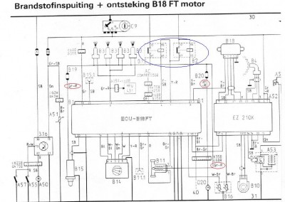

so i have just got this old girl of T.J its a 340 1.4 with a b18ft i can do the engine pipe work and mechanical work fine but i am not very good at wiring :? any help would be much appreciated!

Hi!
I have made a b18ft engined 360. So I could help you a bit.
First of all the grey-red wires are switched + by the 2 main relays (near the ECU).
Idle motor, O2 sensor, injectors...
Gray can be after ignition +.
But the red wire could be the third pin for idle motor (if it goes to ECU pin 10)...
If you want some pics, please send pm.

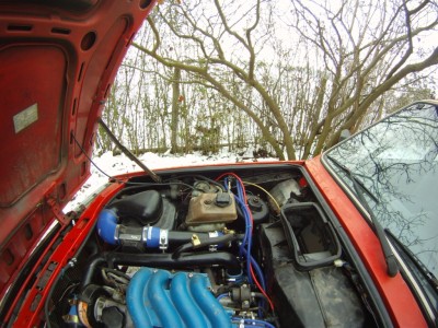

Post by jezypeti » 16 Jan 2013 12:41 pm
Pics of the enginebay. Sorry for gopro.
I dont think, this would help you...
If you are interested in some details, please ask!
Re: 340 turbo help? (trundle)
Post by Chris_C » 16 Jan 2013 02:35 pm
I wish my B18ft not done project was left hand drive!
Good use of the 360 air box too.

Post by theashboi » 16 Jan 2013 06:34 pm
Pics don't help my engine bay looks a lot different :? I will take sum pics when I get home later it is just sum wiring to do and it shod start the pump and sender are in the tank fuel lines are in rad pipes and oil are dun along with the throttle and new starter motor just need the little bit of wiring left so frustrating sm2

For startermotor, you can use the stock wiring harness (blue-yellow wire I think). And you need only connect it to the battery too.
Right hand drive... I couldnt drive from there :oops:
I'm witing for pics.
(It was 360, so I have the battery tray in good location. And the air box is stock :mrgreen: )
