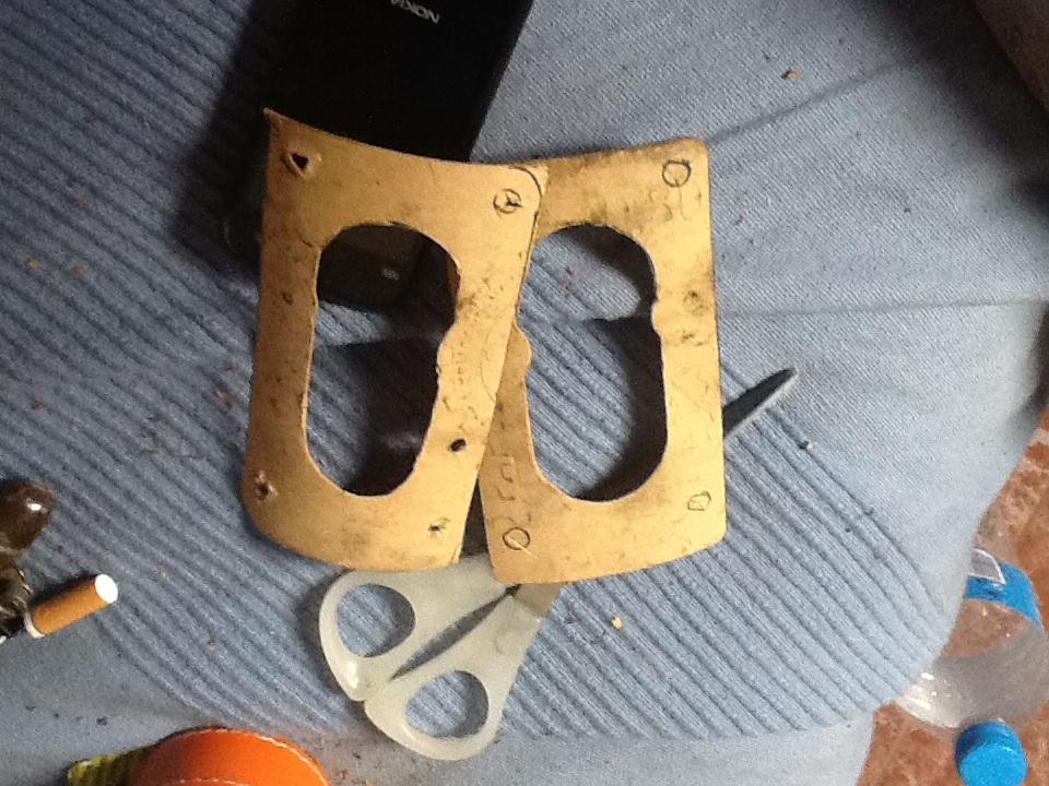

Looks good!! If i read this before.... I cut some gaskets but your looks 340pw
Jejej the next time i takl to you first!!

Just a quick note - looking at the gaskets you have made they look very like the one that fits between the original block and the carb (with the "green" block you use the rubber/shim supplied and don't need a further gasket).
The gasket you need to go between the new block and the manifold (or to use with the thin plate in the original set up) is different! The bolt holes and centre opening are the same of course BUT the extra "spigot pin" holes are differently placed.
(it will be obvious when the kit arrives and you can trial fit your gaskets).
It's quite all right to make your own gasket, but if you have a problem PM me your name and address and I'd be happy to pop you one in the post.
Mac.

Yes, i copy the black block top, when arrive green i do other. Thanks for the info!

You can copy from the lower thin plate (with a gasket bonded on both sides) you won't reuse it but bottom of the green block has the same shape and spigot configuration.
Best of luck - Mac.
