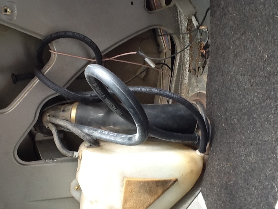

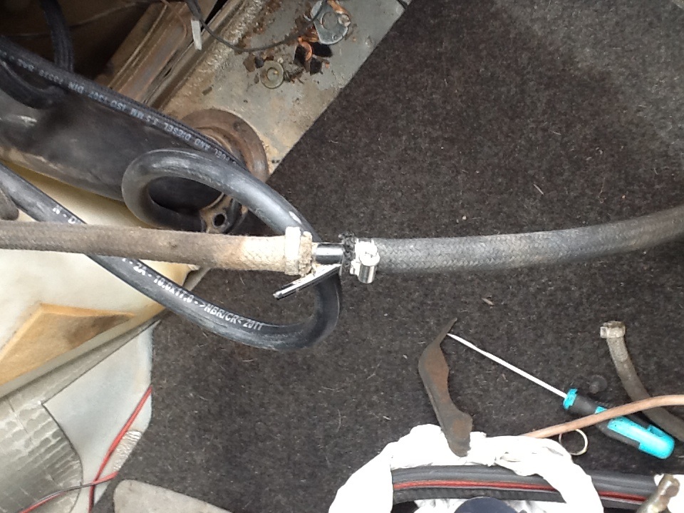

Mmmmmmm well... In that post describes the same problem. But since i change some hoses car smells less. Tomorrow i post some pics. The last thing that i going to do is fully fuel the tank to see if they leaks, that is the second thing i see after the smell

Old hose
New hoses

I dont put the t piece of the old hose, and take the hose from the bottom of the small tank upper posible, to if in the tank apears fuel it dont leaks, and i can see if the sistem works

Post by Busicrx » 27 May 2013 01:07 am
The hoses of the engine bay seems been changed, not 20years.. The longer hose its because im still thinking if the t piece is necesary , im cornering high to see if leaks in some place to determinate this.
