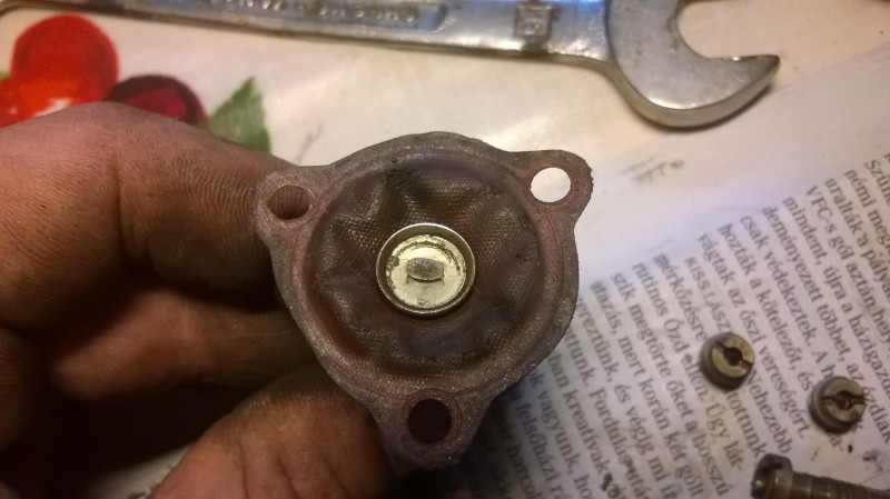

The choke pull of diaphragm not in good condition Can I buy separately?

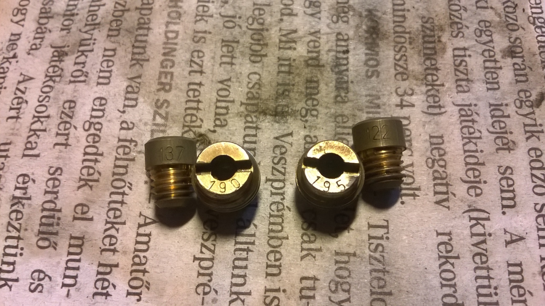

But i do a mistake. I wont separate the primary and the secondary jets. Which pairs? 1st: 122-190 and 2nd: 137-195?

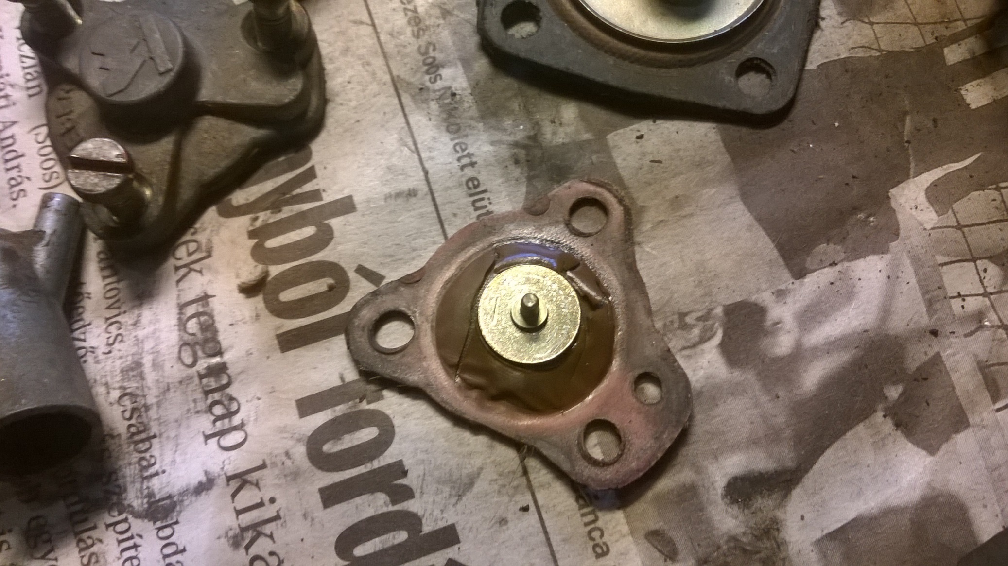

Well - your full load enrichment diaphragm is definitely split!.
The choke pull off actually does not look too bad - the "crumpling" is normal - the key is does it leak?
When you reinstall the full enrichment device cover make sure it's positioning is correct - the W symbol does NOT sit horizontal.
Jets - Primary Main would be 122 and Secondary Main 137
Primary Air Correction would be 195 and Secondary AC 190

choke pull-off maybe usable. I live in Hungary. I think the post little expensive
