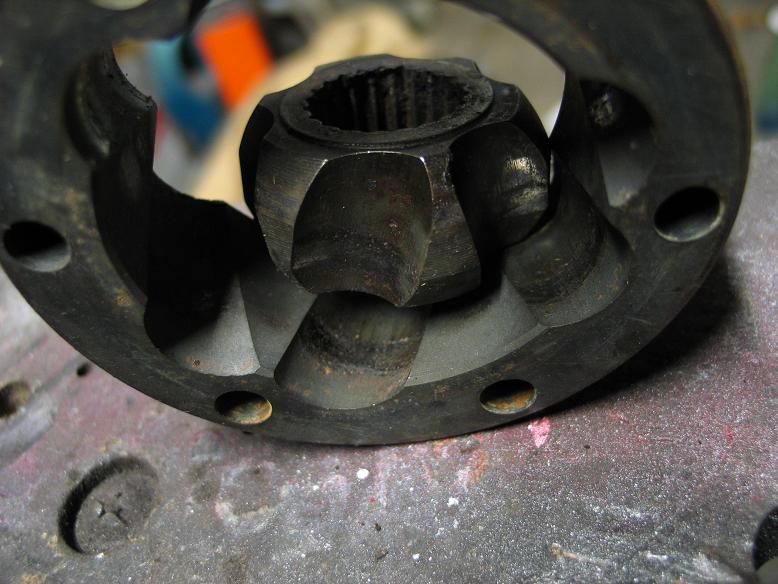

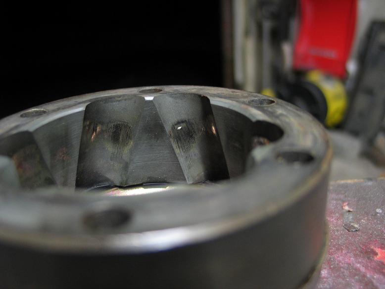

I've refurbed the 4 340/B200K shafts and made 3 good ones. The ball bearings seem to be 3/4" / 19.05mm spec.
It was fairly easy but alot more work than I thought, the main difficulty was seperating the splines from the inner race, its almost an interference fit in some cases and you need to support the inner race while hammering the shaft out. I could not get a puller to work but it might be possible if you remove the back plate and disassemble the joint from the outside. Even on reassembly heating and cooling the opposite parts did not help much.
I don't think the miles or pressure made that much of a difference, probably more down to grease breakdown, and/or sealing against water. All the boots where good prior to laying up and no seepage, possibly main area of failure was the tin plate cap. Although having said that all the joints worked ok prior to dissassembly.
B200E shafts have arrived so will post some details soon.
- Attachments
- spares and rejects
- IMG_1754s.JPG (93.4 KiB) Viewed 13079 times
- Good parts
- IMG_1740s.JPG (53.63 KiB) Viewed 13080 times
- Finished items with SS clamps and sprayed up
- IMG_1753s.JPG (106.51 KiB) Viewed 13080 times
- Chipped high miles 360
- IMG_1739s.JPG (39.95 KiB) Viewed 13080 times
- low milage 340, scored and rusted
- IMG_1750s.JPG (61.41 KiB) Viewed 13080 times
- pitted and worn (200K miles B200K)
- IMG_1748s.JPG (73.23 KiB) Viewed 13080 times
- corroded (200Kmile B200K)
- IMG_1749s.JPG (82.67 KiB) Viewed 13080 times
