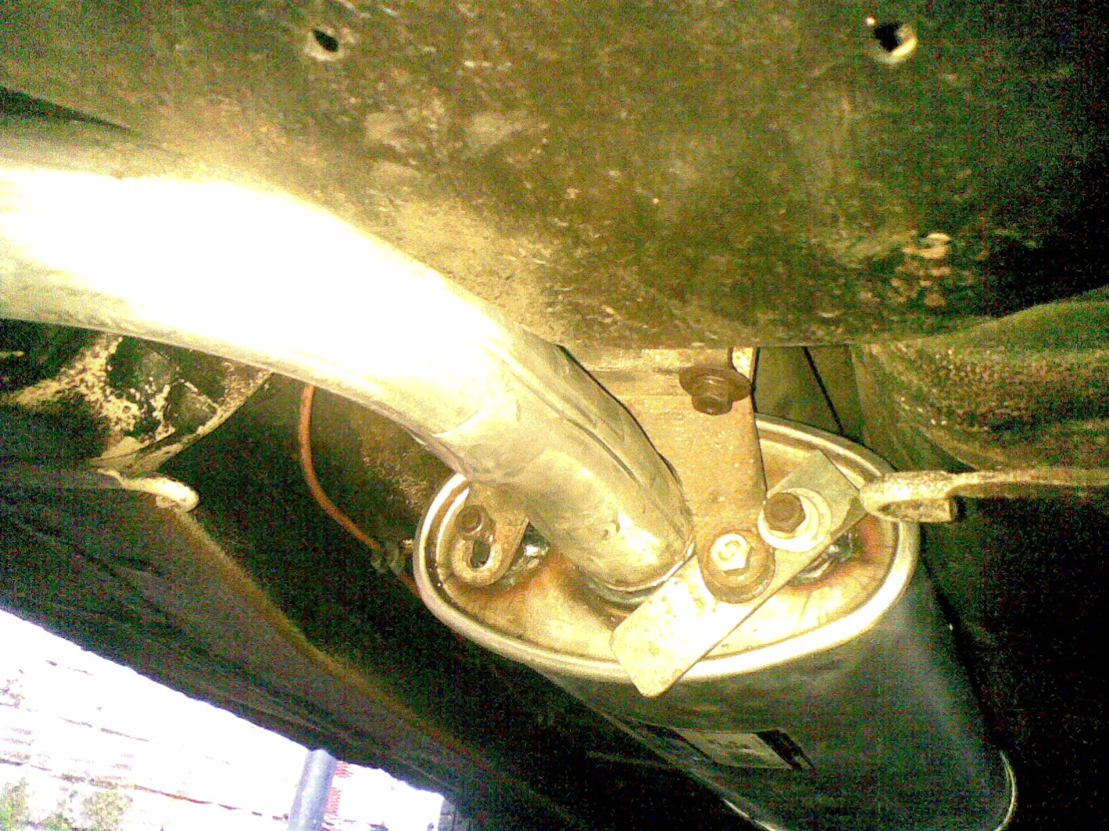

Well, to be absolutely clearius, the new Klarius exhaust section is almost right - just needed a bit of a bodge with the fitting....
.... now, I just need to trim that dodgy fixing plate a bit at the bottom and it might be good to go.

That repair is straight out of Hades. You've outdone me. 340pw

Awesome work - I get you now, thanks to wikipedia: Hades the god of the underworld - man, thats mytho-logical ;-0 .... but, anyhow, here's how the final masterpiece looks after removing the sharp edges and it doesn't thrum too much ;-0 so fingers crossed and the MOT man might not mind too much either...
.... shame they can't just make them bolt-holes the right distance apart - they should take a lesson from rabbits ;-0

Thanks for posting this, I might try and avoid Klarius parts if they can't be bothered to make them fit correctly!

I would think that all these parts are so obsolete now, all you can get now are just returned goods - or should that be bads ;-? Or maybe Klarius make (or made) their own laminated hanging-down bit?? The posh repair would have been to fabricate one of these, but couldn't be bothered, sorry!!

Well done on making that thing fit! I've used Bosal parts for quite a while, the fitting seemed to be OK on those. My DLS has a "Walker" exhaust - mountings OK on that too.

how much clearance do you have with the exhaust tube in relation to the heatshield under the fuel pump?
it think that the exhaust might get too high when mounted like this
