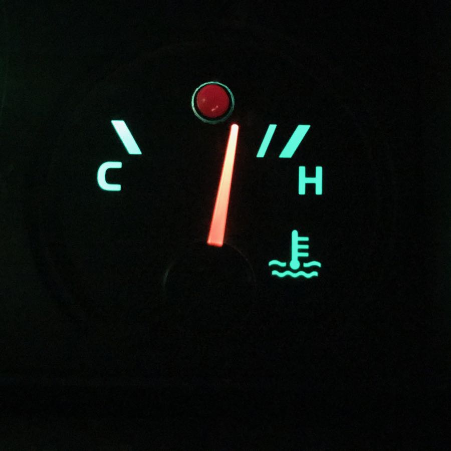

1. Engine temp gauge sits here when it's heated up and stays there. It didn't do this for the first 6 months of ownership with the mileage 45-55k miles:

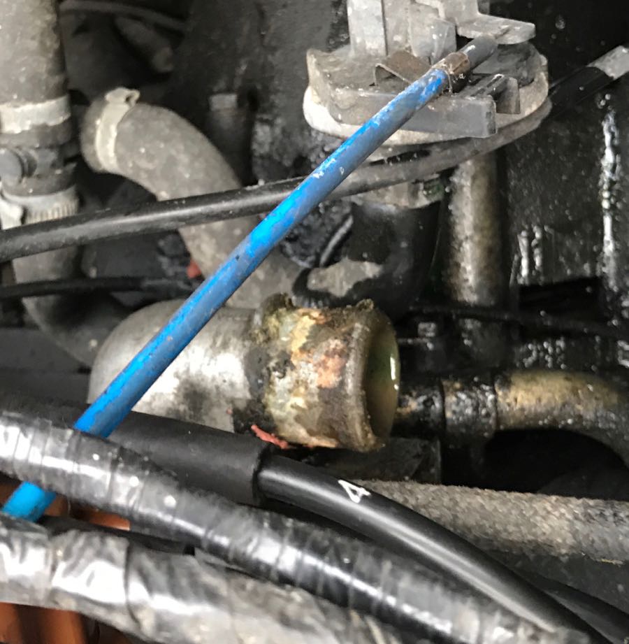

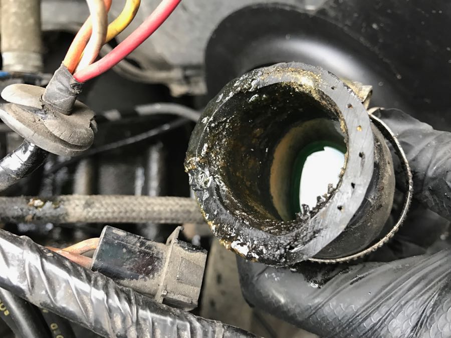

3. No evidence of coolant leaks. However, it was low and has since been topped up. I used some Wynn's Radiator Stop Leak just in case but no change on the temp gauge. I did remove the radiator hose at the back of the engine (lower nearside hose) as it was bulging and may have cracked but not so (just covered in oil from an as yet undetermined leak above it). However, when the hose is fitted and I turn the engine off after heating up, there's a hiss somewhere in the engine bay that stops if I gently squeeze the hose - strange.

Rear engine radiator hose (thermostat housing)

UPDATE: Added just under 1L of oil. The fan comes on just as the temp gauge tips past the middle and that brings it back down to pretty much dead on center. I'll do a full oil change at the weekend (Castrol Magnatec 10w40 A3/B4) as I reckon the oil inside is dead and useless. Thinking about it now it's probably not been changed for nearly 15k miles since the last service stamp 4 years ago and has been off the road for much of the 3 years before I got it.
