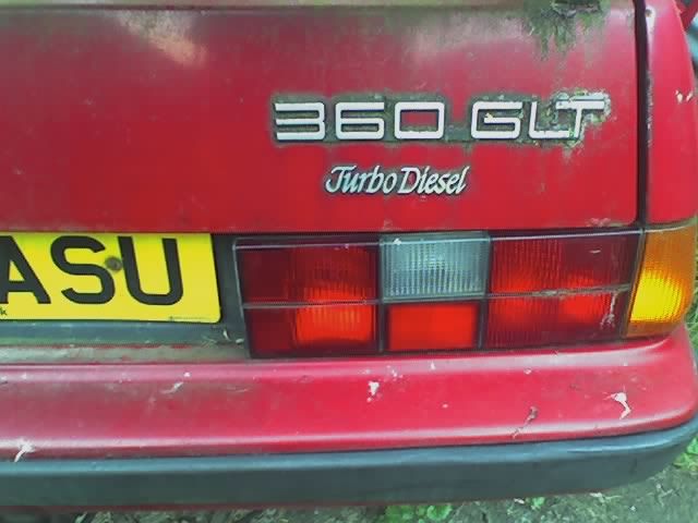

Well, now I may have just the thing for you here mate! LOL, I have a 360 GLT diesel! It's got a Nissan 2.0 Turbo lump in it. I bought it as a project, but other things have taken priority, space is limited, so it looks like it must go. All the hard work has been done, a better body donor would be the best plan, as it's basically in a shell at the moment.
If not, I'd suggest the 1.9 td from a 400, excellent engine, it'd easily compare to the 360 B200E 2.0 petrol lump in performance, and that's in the 400 shell. Lots of torque. The chap who runs the Friends of the Volvo 300 has both I believe, a D16 from Ireland and a 1.9 td lump in a 300. Might be worth a chat. Let me know if you require details.
