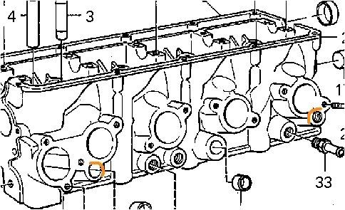

To remove the pulsair you need to remove the manifold. The pulsair pipes can then be removed from the head. Volvo make blanking plates for the holes in the head which I have ( £1.30 each ) so Im going to fit these.

and vadis pic

and vadis pic
