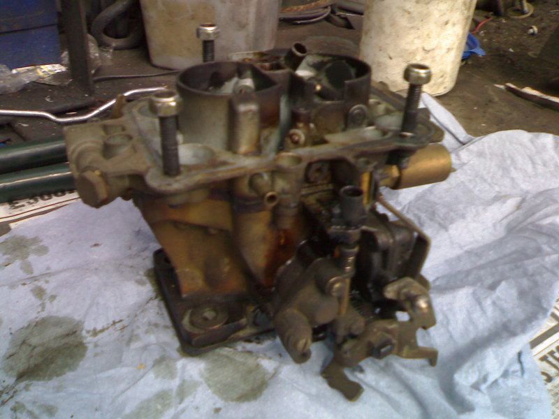

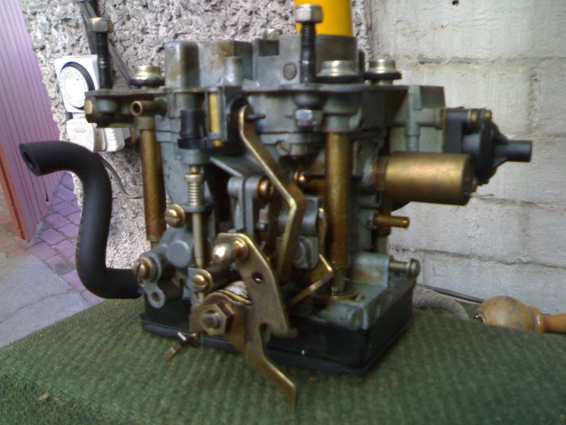

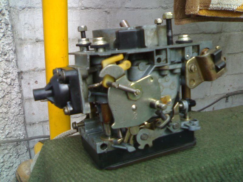

Today as promised i had a look at the carb on Gems car before i go off to uni. I took the carb back to the garage to strip it down and clean all the jets as the car was not starting very well.
I also sorted the stud problem out. Al in all the carb seemed ok al be it caked in 17 or so years of dirt.
All in all the carb no runs very well and the car starts a treat. Just thought i would share some before and after pics!!!
Adam
