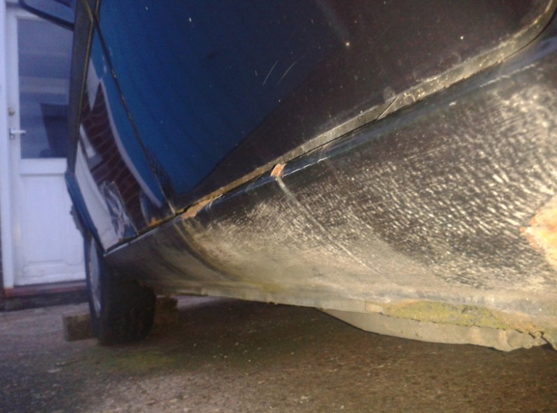

8) Driver's side, rear passenger door sill rusted - maybe 3-4" rust hole developing - didn't want to prod it too much as yet. Again, pretty sure that's an MOT fail

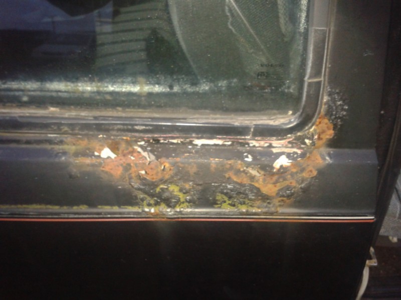

12) All four doors are badly rusted. I know why. The weather strips when I bought the car were bodged. Water gets down past the "weather strips" & into the doors. They could be welded / repaired but water tight weather strips would be required in order to stop it happening again. I haven't been able to find weather strips so far.

The sills look good and, as far as I can see, the underbody is good; rear, roof, bonnet & wings all look pretty good, as does petrol tank. All glass is good apart from windscreen chips but didn't fail 2006 MOT. The electrics all seem to work apart from the electric windows, reverse lights & central locking. Handbrake seems good but I would imagine that, after 7 years with no use, the entire brake system would need a major overhaul - new pipes, discs, pads etc. Can't be sure. The brake pedal seems to function normally. I've never worked on brakes - it's one of my weakest areas of knowledge.
